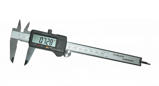

How are you translating your device within that volume? Maybe just use 3 accurate linear displacement mechanisms -- kind of like long versions of calipers...
http://i.stack.imgur.com/AtTpr.gif
Well, I'd perfer it to be able to be positioned without any sort of physical connection to a wall or something like that.
Can you say what the measurement is? If it involves moving an RF transceiver, then any contact measurement technique like the one I suggested will need to involve a non-conducting mechanical structure. The caliper technique can still be used, albeit with less resolution (but still meeting your 0.1mm requirement.
