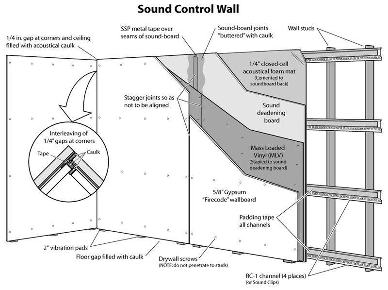

I helped a friend with some construction work on a new house he had built for him and his wife a few years ago. He wanted to add some extra soundproofing to several rooms, so we installed some "sound board" (or something with a similar name) material before the sheetrock was put up. You might consider doing this as you remodel the bedrooms and maybe even the living room:
http://soundproofing.org/images/wall_2d.jpg
