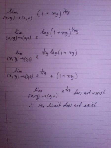

Evaluate the following limits or determine that the limit does not exist.
b) lim (x,y)–>(0,0) (1+xy)^(1/xy)
I have a funny feeling this limit might exist. (Then again I get that feeling about every indefinite limit...) Can this be simplified further?
I tried converting ƒ to e^log ƒ to get rid of the exponent. Work attached.
Is there a better way of dealing with 1^∞ indefinite limits in more than one variable? Something with more of a multivariable calc flavor?

Doesn't this remind you of limx→0(1+x)1/x ?
By the Way: If you do your last step correctly, you merely get the original problem back.

On your attached work sheet:
The line with the following is correct.
[itex]\displaystyle \lim_{(x,y)\to(0,0)\,}e^{\displaystyle \frac{1}{xy}\ln\left(1+xy\right)}[/itex]​
The next line is incorrect. It should be either
[itex]\displaystyle \lim_{(x,y)\to(0,0)\,}\left(e^{\frac{1}{xy}}\right)^{\ln\left(1+xy\right)}[/itex]
or else what you started with.​
The point is to get
[itex]\displaystyle e^{\left\{\displaystyle \lim_{(x,y)\to(0,0)\,}\left(\frac{1}{xy}\ln\left(1+xy\right)\right)\right\}}[/itex]​
