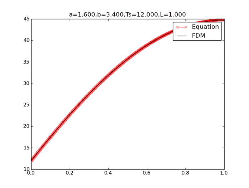

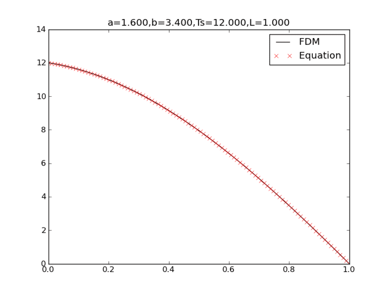

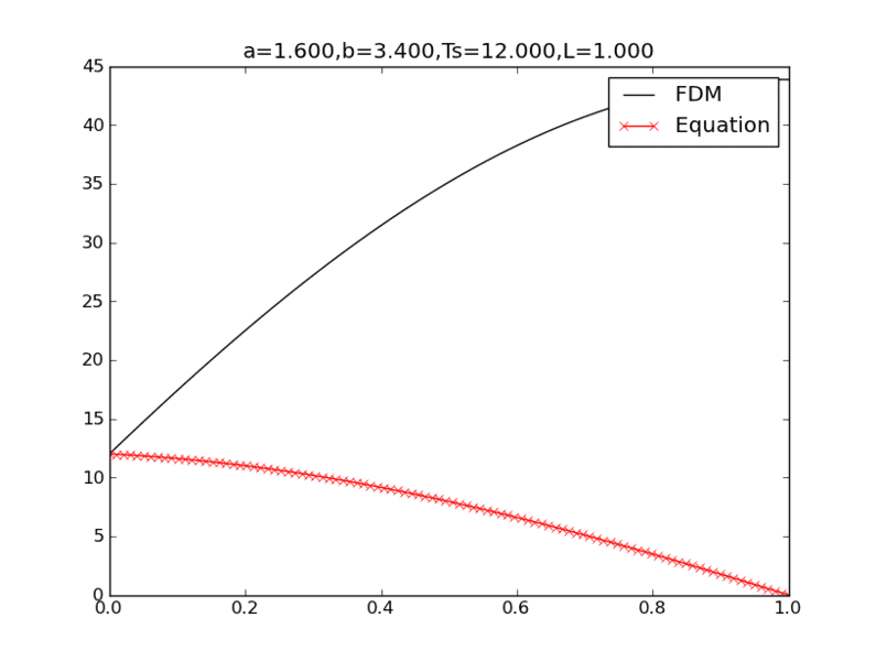

pmsrw3, very close! Please see the following two plots:
The equation you gave models the homogenous boundary problem exactly, which is:
Txx + aT = -b, T(x=0) = Ts, T(x=L) = 0 (first plot)
What I need is the solution to the NON-homogenous boundary problem:
Txx + aT = -b, T(x=0) = Ts, Tx(x=L) = 0 (second plot)
the difference being that the x=L boundary is Neumann, not Dirichlet.
Can you do what you did again with this Newmann boundary?

Oops, sorry. I must have left out a '.
[tex]
T(x)\to \frac{(a T_s+b) \sec \left(\sqrt{a} L\right) \cos \left(\sqrt{a} (L-x)\right)-b}{a}[/tex]
I simultaneously found the solution. The form is
T(x) = C1*cos(sqrt(a)*x) + C2*sin(sqrt(a)*x) - b/a
where C1 = Ts + b/a, C2 = C1*tan(sqrt(a)*L)
Your solution looks like it takes this form after some trig flexing.
