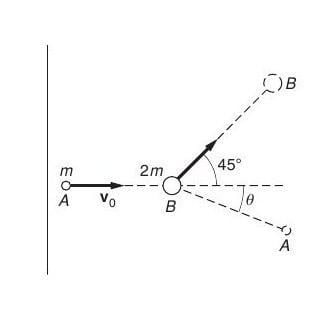

Particle A of mass m has initial velocity v0. After colliding with particle B of mass 2m initially at rest, the particles follow the paths shown in the sketch (see attachment). Find ##\theta##

The momentum before and after collision is
\left\{
\begin{array}{}
\vec P_i = mv_0 \hat \imath \\
\vec P_f = (mv_0' \cos{\theta} + \sqrt{2}m v_1')\ \hat\imath + (-m \sin(\theta) v_0' +\sqrt{2}mv_1')\ \hat\jmath
\end{array}
\right.
By conservation of momentum, ##v_0'## and ##v_1'## can be expressed in terms of ##v_0## and ##\theta## :
\left\{
\begin{array}{}
v_0' = \frac{v_0}{\cos(\theta) +\sin(\theta)} \\
v_1' = \frac{v_0}{\sqrt{2}} \frac{\sin(\theta)}{\cos(\theta) +\sin(\theta)}
\end{array}
\right.
Now in terms of energy:
## K_f = \frac{1}{2}mv_0'^2 + m v_1'^2 = \frac{1+2t^2}{(1+t)^2} K_i##,
where ## t = \tan(\theta)##.
The ratio between energy lost in the collision and initial kinetic energy is:
## \alpha = \frac{Q}{K_i} = 1 - \frac{K_f}{K_i} = \frac{t(2-t)}{(1+t)^2} ##
which can be re-written :
## (\alpha+1) t^2 + 2(\alpha -1) t + \alpha = 0 ##
The roots are real numbers only if ##\alpha \le 1/3## which is the same as saying that no more than one third of initial energy can be lost in the collision. In that case:
## t = \frac{1-\alpha}{1+\alpha} \pm \frac{\sqrt{1-3\alpha}}{1+\alpha} =
\frac{K_i - Q}{K_i+Q} \pm \frac{\sqrt{K_i}\sqrt{(K_i - 3Q)}}{K_i+Q}##
The answer will be ##\theta = \arctan(t)##, but which root should we keep ?
Look at your diagram, which would be consistent with momentum conservation?
The diagram suggests that ##\theta## is smaller than 45 degrees. So we should have ##0<t<\frac{\sqrt{2}}{2}##.
For exemple, the '+' root is not acceptable for ##\alpha = 1/6##, so I think we have to keep the '-' root. Right?
Sorry, I made a mistake, ##\tan(45) = 1## and not ##\frac{\sqrt{2}}{2}##, but I reach to the same conclusion. Do you agree ?

My result is consistent with perfectly elastic collision: take Q = 0 and keep the '-' root. You'll find that the angle is 0. Conversely, that angle conserves kinetic energy.
However, the bigger particle would be at rest after the collision, which is in contradiction with the diagram. So the collision is inelastic.

Also, there's no way the angle can be 0. That would mean momentum is not conserved in the j direction.
wait...
For an elastic collision, ##\tan(\theta) = 0## or ##\tan(\theta) = 2##.
First option is impossible because momentum is not conserved.
Second option gives ##\sin(\theta) = 2\cos(\theta) ##.
That gives :
##K_f = \frac{K_i}{9}(\frac{1}{\cos^2(\theta)} + 4) ##
By conservation of energy, and if there is no mistake, ##\theta = \arccos(\frac{1}{\sqrt{5}}) ## which is approximately 63 degrees.
