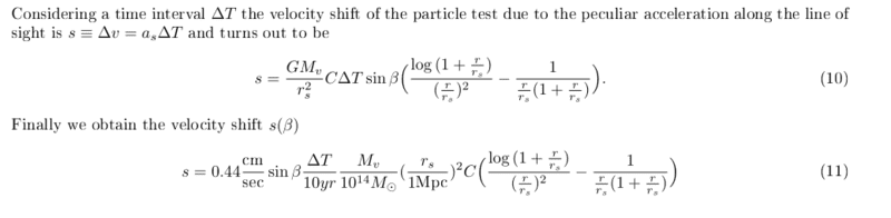

I was reading an article and I saw this expression,
I don't understand how the ##r_s^2## in the denominator (in Eq.##10##), becomes the numerator in the Eq.##11## ?
Article is here: https://arxiv.org/abs/0708.1132
Space news on Phys.org
You can work out what's happened by comparing terms. ##G## in equation (10) has been replaced by some largely numerical expression times ##r_s^4##.
