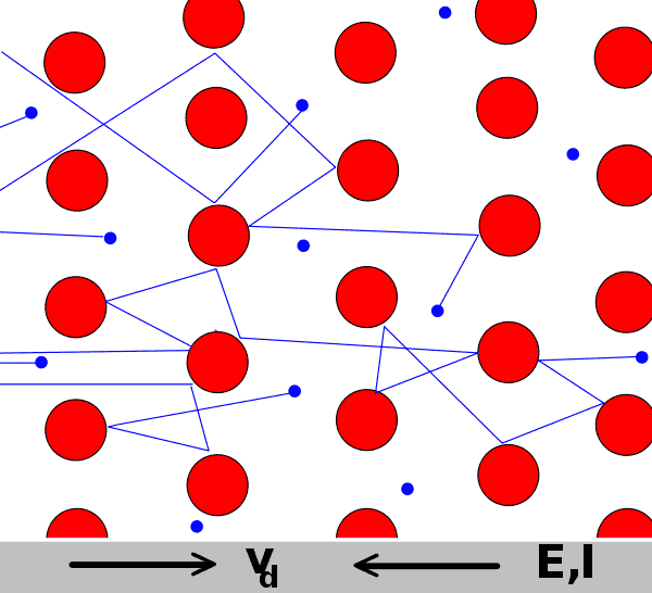

John3509 said:
To simulate AC, i take a marble
That was a worthy try, but the reality of conduction in a wire is too complicated for such a simple model.
For one thing, the moving electrons have many collisions with atoms in the solid.
See https://en.wikipedia.org/wiki/Drude_model To make an analogy with marbles, the wire is not a hollow tube, it is like a Japanese pachinko game or a pinball machine.
Also electrons repel other electrons. That means all the electrons in the wire have forces that are like springs that connects every electron to every other electron. Marbles don't have that.
There are even more complexities that I won't explain. Bottom line, there is no simple analogy of electrons behaving like marbles or water that comes close to the reality of current in a wire. It is one those annoying cases where simplifications don't work.

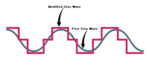

But there's an easier way to think about your AC versus DC question, that does not mention electrons. The key relationship, P=VI, power equals voltage times current. it works for AC and DC, and it works instantaneously. So think of an instant that is so brief, that even a sine wave varying AC current is approximately constant for that instant. Constant current for an instant is the same for AC and DC. Therefore, in an instantaneous view there is not difference between AC and DC. That is the simple answer to your question about AC versus DC power losses.
This picture helps illustrate this point. A series of steps approximates a sine. The more steps, the better the approximation. During the flat part of each step, it is like DC.
It is only when we consider averages over long times, that the AC/DC differences arise. Actually averages of a number of complete AC cycle, that the complications come it. Complications like peak versus RMS measurements, imaginary power. But when you return to the instantaneous view where V and I are approximately constant for the instant, all the differences between AC and DC power losses vanish.
There is also a middle view, where V and I may vary with time but not necessarily as a sin wave. We can write differential equations including terms like IR, LdI/dt, and CdV/dt and solve those for voltages and currents versus time including inductance and capacitance. In that approach, there is also no such thing as AC, but only time varying quantities.
Let me repeat for clarity. The whole topic of AC electricity applies only when we use averages over one or more complete cycles. When we model electricity instantaneously, we do not use averages and there is no such thing as AC.
