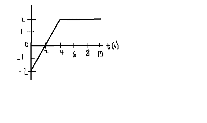

The first one is a straight line with slope 2, the second one is a straight line with slope 1/2, and the third one is a parabola (open upwards) that intersects with the other two lines at t = 0 and t = 4.
Drewski
The figure below shows the velocity-time graph of a train that starts from the origin at t = 0s
a) Draw a position-time graph and an acceleration-time graph for the train
b) Find the acceleration of the train at t = 3.0 s

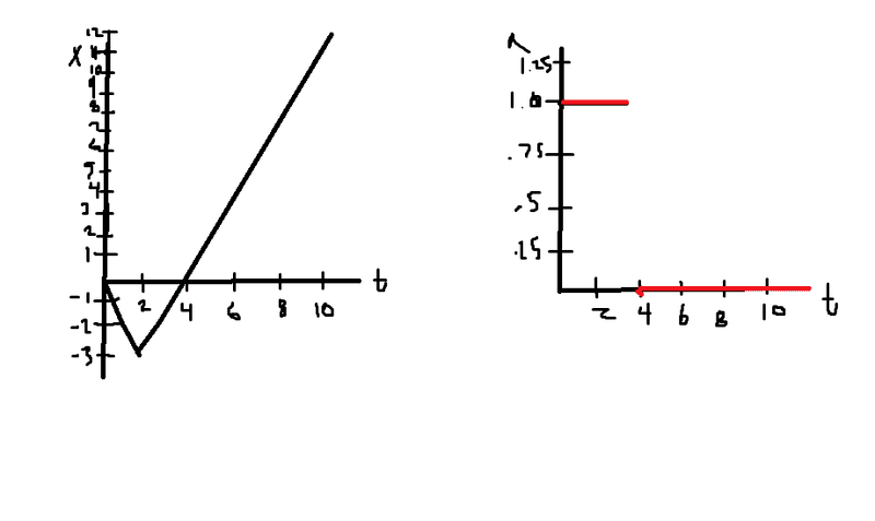

a)
b) 1 m/s^2
Do my answers look right? If not, what did I do wrong?
The acceleration is correct, and the graph of x(t) is almost correct, only the part between 0 and 4 s does not look parabolic, and check x at t=2 s. ehild
Looks right to me. But those are really, really, truly, bad graphs.
