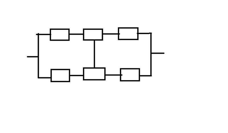

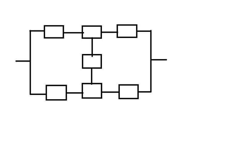

Question: A system consists of 7 equal reliable components having the following configuration with each component has a reliability of 0.9. Find the reliability of the system.
I was taught (and only been taught) with the calculations to obtain reliability of a system with its components arranged in either in series or in parallel. However, I have real trouble in solving these kinds of complex configuration.
For series: Rs = R1R2...Rn
For parallel: Rs = 1-(1-R1)(1-R2)...(1-Rn)
I have search through the internet and realized that this can be solved with the solution used for bridge structure. I tried to mimic the way the solution from the resource (Reliability Engineering: Theory and Practice, by Alessandro Birolini) found (but with only 5 component instead of 7) and come to this:

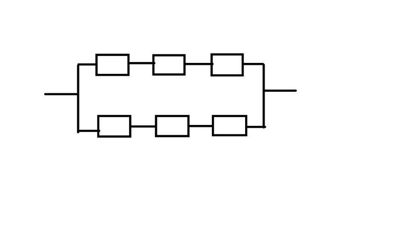

The first picture showing the reliability of the system with the center component not fail, and the second picture is when the center component has fail. (component number order: 1 to 6, from top left, clockwise; center = 7)
Then, Rs=R7(R1+R6-R1R6)(R2+R5-R2R5)(R3+R4-R3R4) + (1-R7)(R1R2R3+R4R5R6-R1R2R3R4R5R6)
This solution doesn't lead to the answer (0.9575). I tried using Binomial method by considering all sort of possibility but still no help (duh, obviously:frown:), so can anyone enlighten me?

Label the components as
[tex] \begin{array}{ccc} A & B & C \\
&G& \\
D & E & F
\end{array} [/tex]
Imagine we want to send a signal from left to right; the component reliability is the probability that a signal gets through that component. So, to send a signal from left to right, at least one path from left to right must be "open". There are four paths: P_1 =in-ABC-out, P_2 = in-DEF_out, P_3 =in_ABGEF-out and P_4 = in-DEGBC-out. If we let ##E_i## be the event that path ##P_i## is open, can you figure out ##\Pr(E_i)## for each ##i##? For ##i \neq j##, can you see how to get ##\Pr(E_i \cap E_j)##, etc? You need to find
[tex] \text{system reliability} = \Pr \{ \text{at least one of the events }E_1, E_2, E_3, E_4 \text{ occur} \}[/tex]

Your answer is correct (although I would round it off to 0.9384). The 0.9575 figure is wrong. In fact, using your (correct) expression for ##R(r)## you can solve the equation ##R(r) = 0.9575## numerically, to get ##r = 0.91797978##.
