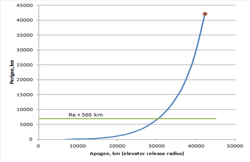

My understanding was different -- that regardless of the nature of the central force, conservation of angular momentum (aka equal areas in equal times) assures us that tangential velocity of the diver at low altitude will be higher than he started with at high altitude.
Likes CWatters
You're talking about Kepler's Law? [googles] Hmm, I didn't realize that was about angular momentum, I thought it was conservation of energy!
Either way, my thought on the broader issue was that atmospheric heating on re-entry becomes significant at a far lower altitude than where the tangential velocity at the top of the tower starts to throw the skydiver into an orbit. E.G., the tangential velocity at 200 miles altitude is only 544mph, a speed you reach vertically in 15 seconds after jumping.
Maybe this is a standard problem, but I suppose it would be interesting to figure out how high the tower needs to be for the skydiver to achieve orbit.
Edit: Yep, it's been done:
https://space.stackexchange.com/que...-space-elevator-to-get-a-stable-elliptical-or
