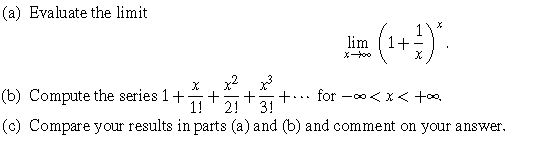

Software assignment - Evaluate the limit & compare the series
In summary: This thing is growing really fast. x=0 and x=10 are the largest terms. I'm not sure how to stop it from growing.
A.Q
Software assignment -- Evaluate the limit & compare the series

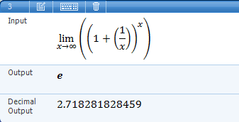

In part a, I used Microsoft mathematics and found it e
In part b, I used [itex]\sum[/itex] but I can't find the right formula
I don't want an easy answer but I really have no idea about part b, it's not even in the textbook

I'm assuming this is an exercise in using some type of CAS software such as Mathematica or other and not a programming exercise to compute these things numerically. So what you need is to come up with the summation formula for part b, that is:
[tex]\sum_{n=0}^{\infty} a_n x^n=1+x+\frac{x^2}{2}+\frac{x^3}{3!}+\cdots[/tex]
well, [itex]x^0=1[/itex] and then they're all just increasing powers so part of it is just
[tex]\sum_{n=0}^{\infty}a_n x^n[/tex]
and the others are just increasing factorial functions [itex]\frac{1}{0!}, \frac{1}{1!}, \frac{1}{2!}[/itex] and so on. So what's [itex]a_n[/itex] then?
The series in part b is one of the most recognizable there is. IDK what kind of book you are using, but I'm surprised it's not in there.
Anywho, you can evaluate the sum thru the first 10 terms or so with a calculator. I think you'll be amazed at the result.

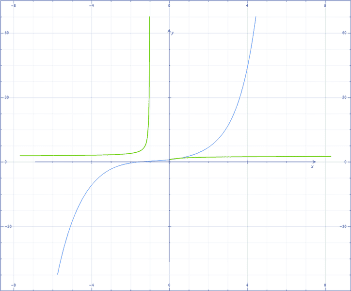

I've plotted the first 10 terms and I was really amazed because there isn't any similarity between it and (1+[itex]1/x[/itex])[itex]^{x}[/itex]
how should I compare part a & b
What're you doing? This isn't a plotting exercise. You've got to find the SUM of the series in part b.
For part b, let x = 1 and sum up the first 10 terms or so. Compare that result with what you got in part a.
You can use Mathematica or MS Mathematics or the simple Calculator app. Takes less than 5 minutes.

I've got it but why x=1.
the question says -inf[itex]\leq[/itex]x[itex]\geq[/itex]inf . How I'm supposed to get the hint that when x=1 the series equals e
