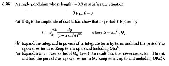

Drowning in alphabet soup. Can you define all your variables? A picture might help.
Sure thing, here's the actual question.

Get rid of the ##\pm## sign in your expression for ##t##, The quantity ##( \cdots )^{1/2}## in the denominator is always ##> 0## (by definition of the 1/2-power function), and ##t > 0## also. Therefore, choose the + square root.

You might want to rethink this. The denominator comes from solving for the speed in ##\frac 12 mv^2 + \frac 12 kx^2 = E##, and the potential term corresponds to a force ##F = -kx##. That's not the same situation you have for the pendulum. The restoring torque isn't a linear function of ##\theta##.
