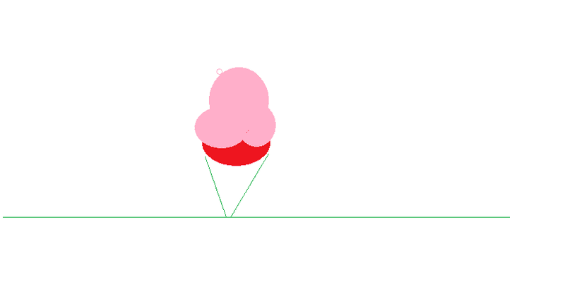

yes, actually you can, if you put your finger under one of the 'holes' , then would I say the center of mass is still directly above my finger?jbriggs444 said:Sure you can. But how is that relevant?
The center of mass would be directly above the point at which the floor and cone contact. Refer to post #5 for a definition of "directly above".goonking said:lets say I balanced a ice cream cone on the floor:
would the center of mass still be at the point where the floor and cone contact?
i understand now, tyjbriggs444 said:The center of mass would be directly above the point at which the floor and cone contact. Refer to post #5 for a definition of "directly above".
