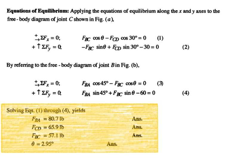

i know this doesn't fit here right but i didnt know where else i could ask this
how did they solve 1 through 4? it should be easy but i can't solve it :frown:
thanks for any help
You want to manipulate the equations to eliminate variables. For example, what happens if you add equations (1) and (3) together? Try this and see if you can proceed further.
ok thanks i solved it
