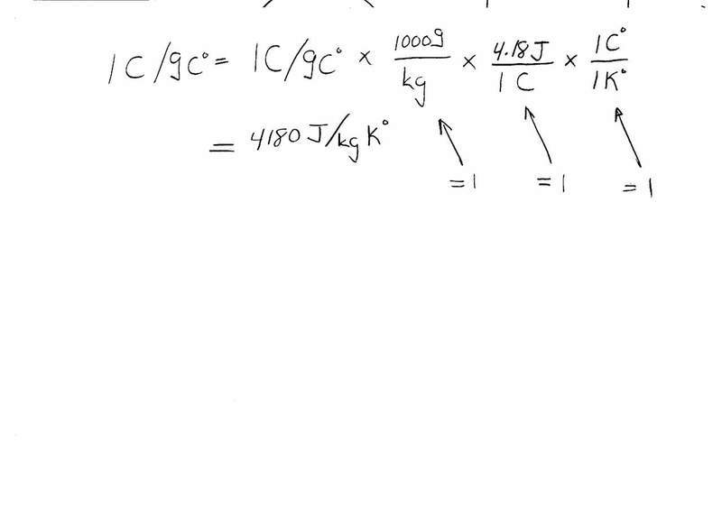

given the specific heat of water is 1.00 cal/(g*Celsius), what is the specific heat in Joules/(kg*Kelvin)
I realize that this is simply a conversion factor issue but I have NO IDEA how to even start it..
I know the conversion favor for g to kg but that's it...
If you multiply something by one you don't change it, see,
