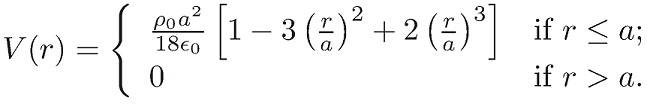

1. A spherically symmetric charge distribution results in an electric potential of the form
What is the charge distribution?
2.
Hint: consider the difference in electric field between two values of r
Show that the answer is of the form
3. I have attempted several solutions but haven't gotten anywhere.
Did you at least calculate the electric field?
E = - ∇ V where the gradient is in spherical coordinates.
I calculated E using the first equation. E=dV/dr
Correction E=-dv/dr <-- I am unsure to just have dr=dr or dr = (the derivative of everything in the 1st equations brackets[] ) - I decided to just have it equal dr
I then plugged the E value into the difference equation with r = r, and r' = (r+dr). I took the difference and set it equal to the right side of the same equation, and then solved for p(r). I hoped this would give me something in the form of charge density noted. However, I ended up with a large number of variables which would not simplify to this form.
Any Insights?
You have the right approach. You can neglect the higher-order terms. Keep only the terms proportional to dr.
You can have r'=0 and just integrate the right side of the equation from 0 to r. You now have Gauss' Law, and you can just solve algebraically for [itex]\rho[/itex].
