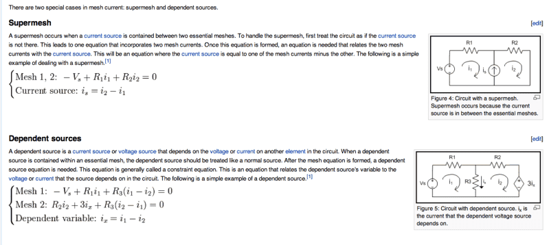

I am doing some review and I though that I had this down pat, but I am getting confused a little. I am looking at the Wikipedia on Mesh Analysis.
I do not understand the last equation of each section. How are they getting the signs of the currents?
In the top image it looks like i1 flows down the middle branch, is flows up the middle branch, and i2 flows up the middle branch, so I would have said that i2 + is = i1 but that is wrong.
In a similar manner, I get the equation in the second diagram wrong too!
Where is my thinking flawed? How can systematically determine the contraint equation no matter what way the currents are directed?
http://en.wikipedia.org/wiki/Mesh_analysis#Supermesh"
Well, I guess my logic does work for the dependent source in the bottom example, but not for the current source...
any thoughts?
In the first example, i1 and i2 are the loop currents. is is the actual current flowing in a branch. That means that the sum of i1 and i2 in that branch must be is.
Since i2 flows in the same direction as is, you write: is = i2 - i1
