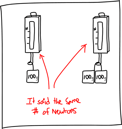

1) What force does a spring scale measure? (I measured several different masses in different ways using pulleys and the spring scale always came up with the same number of Newtons, is this tension or what?)
2) Why, even when two different sized masses are hanged upon a pulley, the spring scale comes up with the same number of Newtons? What does this say about the tension in the spring?
3) If two masses are hanged upon a pulley and one of them is greater, will the smaller one accelerate? If so, in what direction? What about the bigger one? How do they compare in magnitude, and explain this.
1) I think it's the tension but I'm not sure.
2) I have no clue.
3) I believe the smaller one will accelerate upwards and the bigger one downwards but I don't know why and I don't know if the |acceleration| is equal.
Any help at all?
Do you have a sketch or description? a spring scale measures force...if it is installed in the cord, it measures the cord tension...but i don't understand why the tension would be the same when you change the masses...please describe problem in detail.
So is it tension that it's measuring or the net force (including the force of gravity)?
Here's a diagram:
Doesn't seem right. The scale is measuring the sum of the rope tension forces. In case 1, if the mass was hooked to the hook , at rest, the scale would read 1 N. In case 2, it would read 2N. Probably the masses are so small that you can't see the difference in the scale readings. Try using larger weights. Now what happens when one mass is greater than the other? Logically, one moves down and the other moves up, and since thet are connected by the rope, their acceleration magnitudes must be _____?
equal?
Also I goofed up the diagram, they're both being pulled down on opposite sides of a pulley not a spring scale.
