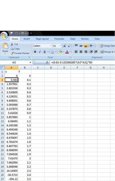

I'm at a complete loss here. Part A was simple enough, and I calculated a terminal velocity of 28 m/s for the ping pong ball and 34 m/s for the golf ball. But I don't even know how to begin Part B. Wikipedia says that Euler's Method is for solving ODE's, which I don't think is first-year material. In any case, I don't even see where time comes from in v(t), here's what I tried:
Fnet = Fg + Fdrag
ma = mg - 0.5pv2AC
Then trying to figure time in somewhere: a = v/t
mv/t = mg - 0.5pv2AC
Then isolate v? Now i have a v(t) function I guess but i guarantee this isn't what I'm supposed to be doing! Please help!

Ok here's the equation for acceleration of the falling ball, if down is positive:
a = g − CρA/2m * v2
So I'm in Excel now, and I'm supposed to use deltaT = 0.1s.
So what I did was this (note the calculation bar to see what i did):
Now from my Vterm calculation I expect this to approach v = 8.9 m/s (thanks StoveBolt), but it breaks down badly for some reason. the way its calculated is as follows:
CρA/2m = 0.125206285 <-- that's where that comes from
Then multiplying that by v2 from the previous interval
Subtract this from g = 9.81
multiply by the current time interval as in v = a/t.
What am I doing wrong here? I'm still kind of confused so please be patient!

I see what you're doing, but regular kinematics equations only work with constant acceleration, and here that's not the case. Acceleration also changes depending on the speed, which is where I am having trouble. I'm not sure which speed values to use for each specific time interval.
You assume that over the small time (0.1s) the acceleration is constant. So you can calculate the change in speed over the time interval.

Regular kinematics equations do work in this case. This is where Euler's Method comes in handy - you assume constant acceleration over each small time interval. This allows you to use a close estimation of the velocity to compensate for the changing acceleration due to increases in drag. You may not get the exact answer, but you will come very close.
Allow me to clarify:
Using the formula:
Vfinal = Vinitial + a*t,
substituting
a = (9.81 - 0.125206*Vinitial2)
t = 0.1
Vinitial = Vfinal from each preceding step.
For each time interval,
Vfinal = Vinitial + (9.81 - 0.125206*Vinitial2)*0.1
Try it out and see.:wink:
