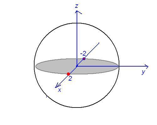

The question asks me to convert the following integral to spherical coordinates and to solve it
just the notations θ = theta and ∅= phi
dx dy dz = r2 sinθ dr dθ d∅
r2 sinθ being the jacobian
and eventually solving gets me
∫ ∫ ∫ r4 *sin2θ * sin∅ dr dθ d∅
How do I find the limits now?
Use the limits in the Cartesian system to figure out the enclosed shape. What is the minimum and maximum value of z? Those of y and x?
Likes uzman1243
x goes from -2 to 2
y goes from 0 to √4-x2 circle with radius 2
z from 0 to √4-x2-y2 sphere with with radius 2
so I am guessing
r goes from 0 to 2
∅ and θ from 0 to 2π
Are you sure in 2pi?
Likes uzman1243
ok so ∅ goes from 0 to 2pi as it is some sort of sphere/ elipse. correct?
See picture. Yes, the shape is spherical, but you have to integrate with respect to y from zero to some positive value, goes it round a whole circle?
Likes uzman1243
ahhh so θ goes from 0 to pi
and r goes from 0 to 2
correct?
Those were the limit for the whole sphere. But the integration does not go for negative z values, neither for negative y values.
r goes from 0 to 2
theta goes from 0 to pi/2
phi goes from 0 to pi
correct?
Looks good.
uzman1243 said:
r goes from 0 to 2
correct?
Yes. :smile:
Likes uzman1243
