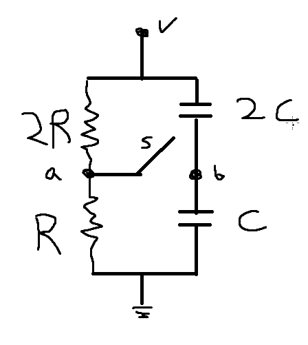

Given V R C for the figure, determine
a.
The voltage of a with respect to b when the switch is open?
b.
Which point a or b is at a the higher voltage?
c.
What is the final voltage of point b with respect to ground when the switch is closed?
d.
Wow much does the charge on each capacitor change when the switch s is closed?
V = IR
V = q/C
charging conductor
[tex] q = CE(1-e^{\frac{-t}{RC}})[/tex]
[tex] i = \frac{E}{R}e^{\frac{-t}{RC}})[/tex]
discharging conductor
[tex] q = Q_0e^{\frac{-t}{RC}}[/tex]
[tex] i = I_0e^{\frac{-t}{RC}}[/tex]
a.
I don't really understand conceptually what's going on, so i'll talk through.. the switch has been open, so the conductor takes all of the charge. getting a is solving the righthalf like a simple series capacitor problem to get voltage at b, voltage at a is just V because 0 current over resister means full voltage reaches a
b.
a would be at higher voltage because it has the maximum possible, b has less because the first capacitor takes some away
c.
At this point I feel like I am surely conceptually wrong, but if you open the switch, the conductors are still going to be taking all of the current and nothing should be changing ?
d.
i would think none given above
I have some hitches in the concepts going on I guess. If anyone can clarify what is going on I'm sure I can get this quite easily. I didn't have much a problem when resisters/conductors weren't together
