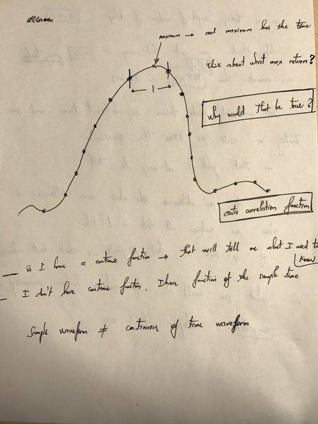

My professor also said:"you don’t have function, you have sample version of the function, the xcorr is a waveform of continuous function, they have a maximum in the current of time. When you work with a sample, the waveform you have entire function tell the value of the function you have discrete time"
and I still do not understand what his mean?

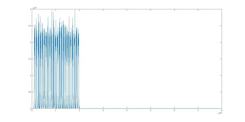

@FactChecker: thank you the reply, I will review first four suggestions from you. and the 5th one I am trying to explain to you:

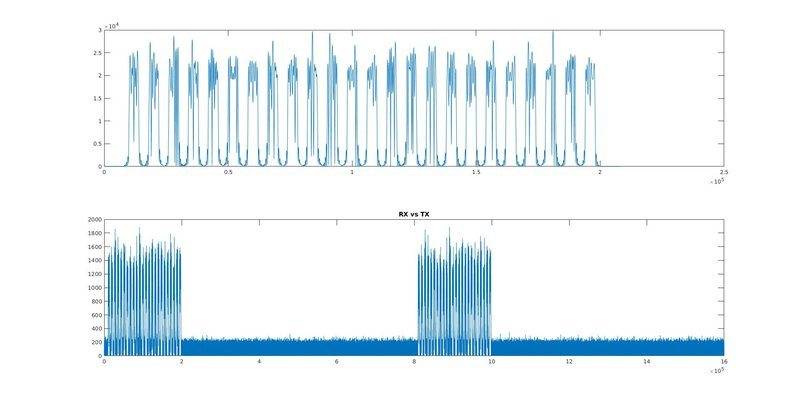

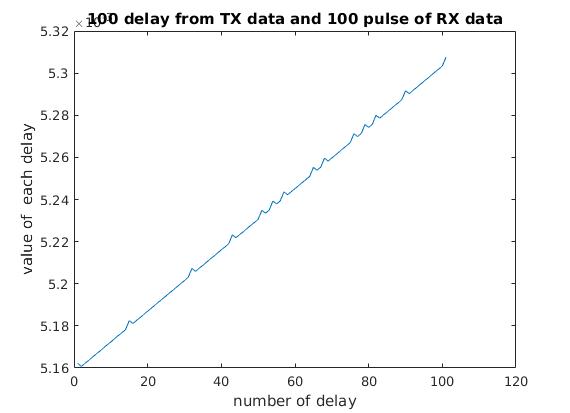

I have 2 signal, 1 for the TX signal and 1 for the RX signal. The TX signal is sent from the transmitter have the waveform lTXdata.jpg and sent repeatly in 100 seconds, therefore, I have the second image TXdata_vs_RXdata.jpg , every second the TX sends to RX, we will have delay, so we have 100 times of delay.
So, I need to cut RX data file out into 100 parts and calculate delay each of them. I am not sure i did right or wrong but my professor mentioned about 100 delays, there is only way to get 100 delays.
and the delay changed as this plot show.

Let me explain what I am trying to do?
I have a transmitted waveform and send to the RX device, such as TXdata.jpg and TXdata_vs_RXdata.jpg so I want to calculate the time delay with expectation is few nanoseconds. I also looked up https://www.mathworks.com/help/signal/ref/xcorr.html , and it is a good example. I applied the similar way from it. Now you said I did wrong and no make sense. That is also confuse me.

It would be more clear if you renamed cc_time to cc_max_index. It is an array of the indices where the maximum absolute cross correlation is achieved.
CORRECTION: Rename cc_time to cc_max_lag_frames. It is the number of frames of lag that give the highest cross correlation.
I think that the absolute value should be removed. You are looking for the maximum positive cross correlation. Negative cross correlations should not be confused with the positive cross correlations.

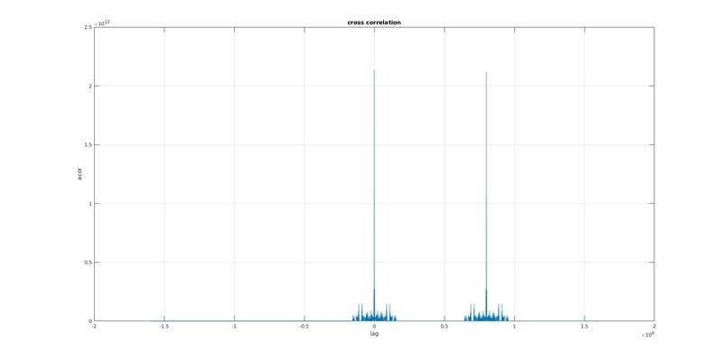

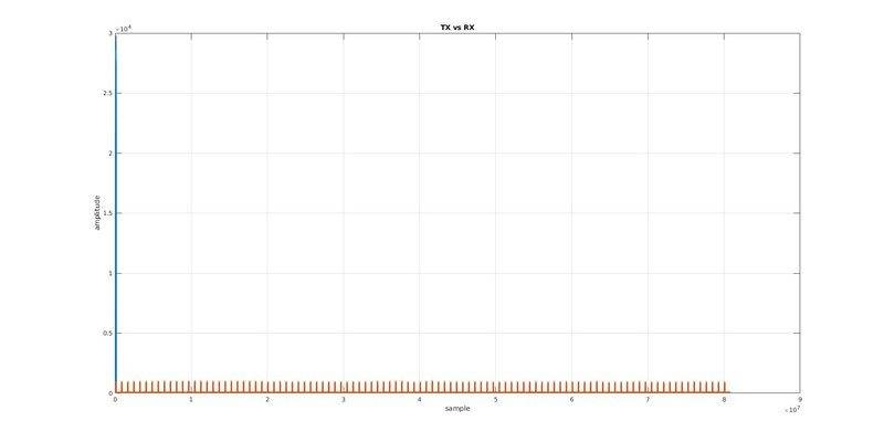

Yes, I did. I already tried with 1 second of data, and still give me the same delay in microsecond, I know the algorithm which I posted, was wrong and I am still trying to figure out the way to get in nanosecond. According to this link which I am following https://www.mathworks.com/help/signal/ref/xcorr.html#bub68m7 and I see nothing wrong with the algorithm:
TX.dat : https://www.dropbox.com/s/zr04pff9skeh8cn/TX.dat?dl=0
RX.dat: https://www.dropbox.com/s/pj9bguc0bu7wtba/RX.dat?dl=0

[acor,lag] = xcorr(s2,s1);
[~,I] = max(abs(acor));
lagDiff = lag(I);
timeDiff = lagDiff / Fs;

I just discussed with the professor, he also mentioned the expectation for the delay will be 3ns or better (less than 1m).
I do not have continue function, I just have function of the sample time (sample waveform different to the continuous of time waveform)
I am taking sample number of delay, that way never going to be more accurate then half of 125ns (about 20m)
I combined data taken in different time and I am treating the result I taken the same.
He also mentioned about the solution on the curve of auto-correlation which is attached below.
Do you have any ideal?

but 1 thing I also thinking of, that is: the professor is asking to find the interpolated maximum of xcorr rather than max sample location. So, the continuous signal is difference from computed sample peak to actual peak is less than 1 sample (mean: at the point after correlating, we have 1 point, and that point will be divided by sample rate Fs, so 1/8e6 ) delay has to be less than 125e-9ns
By actual peak I mean the peak of curve at top, so it requires interpolation between two samples on either side. one way is to use MATLAB interp of xcorr result using very high interpolation rate then find new max and subtract from sample based peak.
SO, do you have any ideal to find the interpolation between 2 samples?

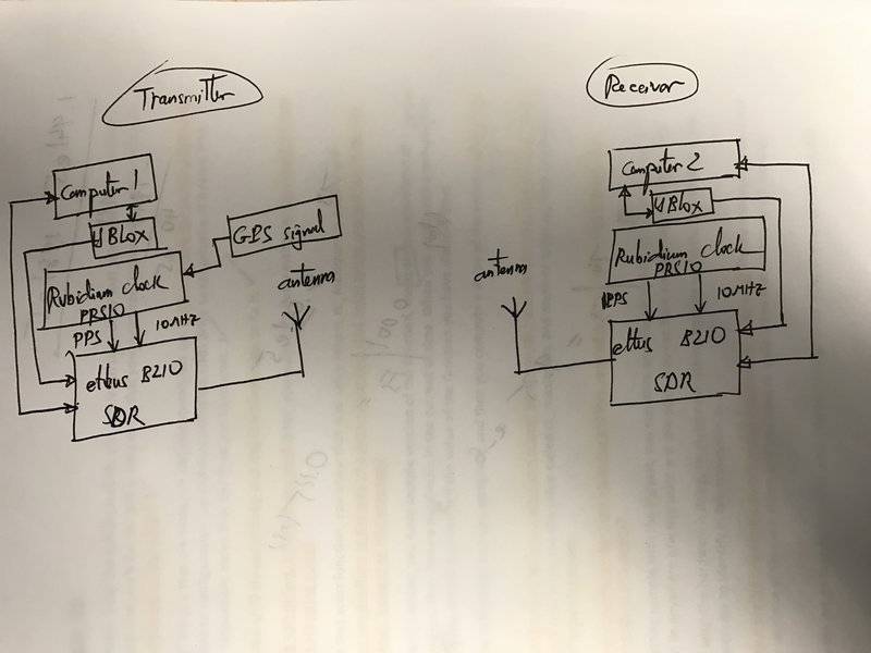

@f95toli: index i means, I calculate delay in multiple RX signal from the receiver (not only one), I want to see the variation of the delay.
For the type of accuracy you desire, I wonder about how your clocks on the transmitter and the receiver are set. On the transmitter side you have a clock that is giving you the time of the recorded transmitted data. And you have the same thing on the receiver side. How are the two clocks set to their time? Are they GPS accuracy (15 - 40 ns) or are they synchronized by an interrupt (? interrupt clock response time)?

@FactChecker: yes, I am using the rubidium clock the time synchronized by interrupt (http://www.thinksrs.com/products/PRS10.htm) and 1 set on the TX and another on set on the RX. the accuracy of it is 5e-11s

I am not sure, but what if they are analog signal? and what if they are digital signal?
I also have an image which show the relationship of them.
lagDiff = lag(I);
timeDiff = lagDiff/Fs;

  • In your system diagram, I don't see an interrupt between the transmitter clock and the receiver clock to force them to the exact same time. I only see a GPS time source feeding one clock. The GPS clock accuracy would need to be researched.
  • You need to find out what is being sent by the transmitter -- a time-tagged message or an analog signal. I am not familiar with transmitter/receivers and the Ettis B210 board. Maybe someone else can help
  • I can't read a data file of unknown format that you put in dropbox.
I'm afraid that I can not help you any better on this. Maybe someone who is more familiar with this subject can help.
