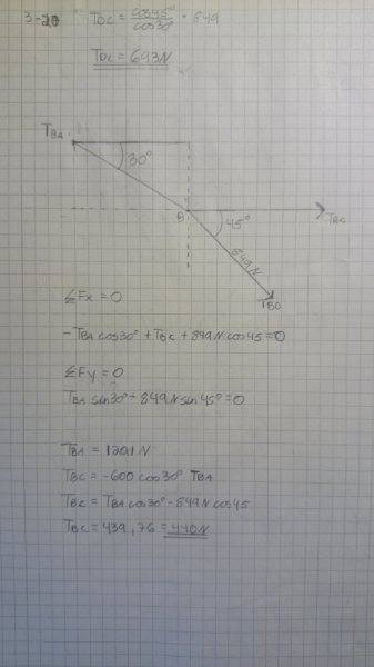

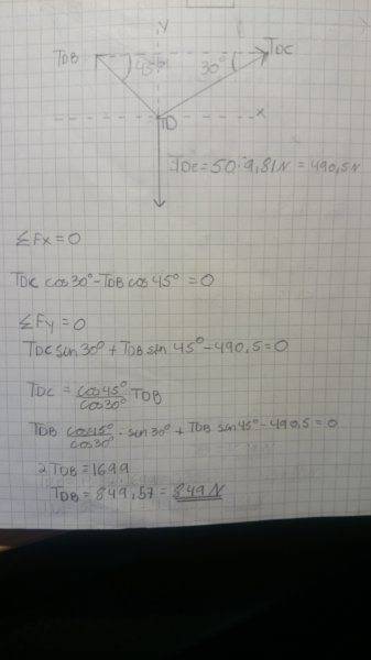

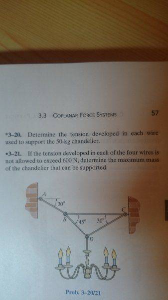

I don't manage to get this task right. See the pictures. First i take point D and draw a free body diagram. Then i use the equation for equilibrium. I can then calculate the tension in the wires that goes from D to B and from D to C. I then take point B and draw a free body diagram, but all the answers i get is wrong. Can somebody please see what i have done wrong?

Method looks ok. Check your working at the bottom of image Task1.jpg. The third line up looks ok. Last two look wrong.
I got...
TDB (1.11) = 490
so
TDB = 441N
Thanks for your reply, and sorry for just putting up pictures. My first time, so i will try to put things together a little nicer. I don't see how to solve that equation. I move 490.5 to the right, divide that with (cos45/cos30)(*sin30) so i stand with TDB+TDB sin45. divide with sin 45 and at last i divide with 2, beacuse TDB+TDB=2TDB. But apparently somewhere this got terribly wrong, and i don't se where.
Ah, now i see what you did, but want you get 2TDB when you add them together?
Here is my working starting with your equation...
TDB*cos45*sin30/cos30 + TDB*SIN45 - 490.5 = 0
Take TDB outside brackets..
TDB*(cos45*sin30/cos30 + SIN45) - 490.5 = 0
Rearrange..
TDB = 490.5/(cos45*sin30/cos30 + SIN45)
Substitute values..
= 490.5/(0.707*0.5/0.866 + 0.707)
= 490.5/(1.12)
= 438N
Not quite the 441N I got earlier.
