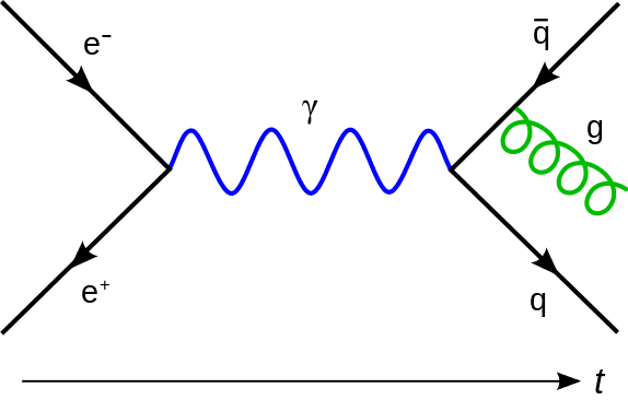

I think the Feynman diagram puts it nicely. A photon is 'exchanged' between them but no energy need be lost. (There's no "why" answer here, of course.)
Image from Wikipedia.
I don't have a copy of Jackson at hand because of Covid. But you can find the expression for power radiation from a multipole and see that it depends on the derivatives.
