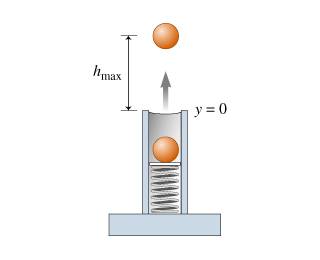

my question is, when using energy conservation when do i put the potential energy of gravity negative? if its under where it set my potential energy to 0? or am i wrong, is gravity's potential energy always positive (except at my set u=0 point) ?
can someone explain this to me, having trouble getting ANYthing done because i do not understand how to set up these homework questionsfor example, this is a ball pushed into a barrel, compressing the spring, ball has initial velocity 0
here are the values,
k = 667 N/m
mass of ball = 1.5kg
ball is pushed into tube .25 meters
if u=0 is set at the mouth of the barrel, then the initial potential energy is mgh+.5kx^2?
or is it -mgh+.5kx^2? -mgh-.5kx^2?
You get to define where the potential energy is 0. Everything above that is positive, below that negative.
what about the springs energy is that negative as well?
meaning if i set the muzzle of the gun to be potential energy 0,, is the total potential energy at the compressed initial part
-mgh-.5kx^2?
Yup, because you also defined the springs 0 potential energy mark at y=0
im trying to find the velocity once it is at y=0 (once it leaves the gun)
i am setting
[tex] -mgh - \frac{1}{2}kx^{2} = \frac{1}{2}mv^{2}[/tex]
i solve this for v and i receive
[tex]
\sqrt{\frac{2(-mgh-\frac{1}{2}kx^{2})}{m}}
[/tex]
i do not receive the correct answer, i get 5.72
k = 667 N/m
i am placing -.25 into the formula since it is below the muzzle, anyone see where i went wrong?
U = mgh+.5kx^2
You get the negatives from the the springs compression and the height, you didn't use
-mgh-.5kx^2 THEN also set x=-.25 did you?
yes i did, i just tried again with correct negatives i think (i see where i went wrong last time)
and i got answer: 3.38m/s, wrong still though
[tex] mgh + \frac{1}{2}kx^{2} = \frac{1}{2}mv^{2}[/tex]
That would be the problem:
[tex]\sqrt{\frac{2(mgh+\frac{1}{2}kx^{2})}{m}}[/tex]
Where x=-.25
The potential energy of the ball is +mgh. If the ball is below th etop of the barrel, h is negative, so mgh will then be negative. The elastic energy of the spring is always equal to +kx^2/2 if its unstretched position is at the top of the barrel.
jesus wrong again, i got 22.89166 m/s this time, lol
i have used
[tex]\sqrt{\frac{2((1.5)(9.8)(-.25)+\frac{1}{2}(667)(-.25^{2}))}{1.5}}[/tex]
o nvm i forgot the sqrt, i got correct answer now! 4.784
thank you feldoh, kamerling
4.784 m/s once it leaves muzzle
solved now though, i didnt know how to properly set any of the initial and final energies, so i couldn't solve it initially, i got it now though.
thanks again
