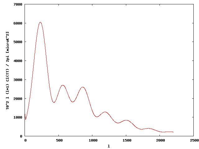

I think saying 80% DM and 20% matter will only destroy the universe we are observing...
You can for example try setting the CC contribution to CMB background to 0, and the densities you proposed to check whether your result fits the actual data.
Of course it will not:
Your generated data ([itex]\Omega_{cdm}=0.8[/itex], [itex]\Omega_b =0.2[/itex] and [itex]\Omega_{\Lambda}=0[/itex]):
A close to measured data CMB angle spectrum ([itex]\Omega_{cdm}=0.224[/itex], [itex]\Omega_b =0.046[/itex] and [itex]\Omega_{\Lambda}=0.7[/itex]):
The age of the Universe can also be affected by making that assumption (drops from 13.72Gyr to 9.311Gyr).
If on the other hand you want to put that much DM to the hot component, then you would destroy the structure formation.
Figures generated by:
http://lambda.gsfc.nasa.gov/toolbox/tb_camb_form.cfm
