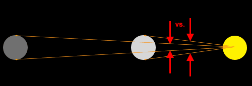

No. Farther things look smaller because they physically subtend a smaller angle in our eye. Our brain interprets smaller angle as either farther away or smaller, depending on other visual cues.
But the smaller angle is still there, even if our eyes aren't. For example, a planet at Pluto's distance will receive much less light from the sun than a planet at Mercury's distance, because Pluto subtends a much much smaller angle of the celestial sphere (from the Sun's position) than does Mercury.
