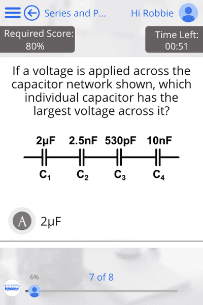

A voltage is applied across the capacitor network in the image shown Below (if it loaded I can only see a small panel with IMG on it), which of these individual capacitors has the highest voltage across it
https://www.facebook.com/photo.php?fbid=1042796789135446&set=a.1042796642468794.1073741831.100002154049134&type=3&size=640%2C960: is in the attached file below ( I hope its
visible )[/B]
: I thought 2 micro-farad would have the largest voltage across it, because its the largest capacitor. But the answer is 530 pf which is the smallest capacitorn[/B]
Notice, the capacitors are connected in series.
What does this tell you about the current through each capacitor and the amount of charge on each capacitor?
Then remember Q=CV or V= Q/C. So what does that tell you about the voltage on each capacitor?

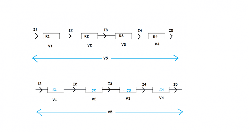

1- I would suggest, in general, you don't talk about voltage as an absolute value in circuits - only as a difference between two points, such as the ends of a component. That voltage can go up or down as you go along. V=IR , so if the resistances are different, then the voltages can be different, in proportion to their resistances.
2 - I asked about the current, that is the flow of charge, through the series of capacitors.
If you want to look at series resistors, then what can you say about the current through series resistors? What does that tell you about the charge flowing through each resistor?
Then, what can you say about the current through series capacitors and what does that tell you about the charge flowing through each capacitor.
Lets forget the voltages until we get that sorted.

On these diagrams, what can you tell me about I1, I2, I3, I4, & I5? What can you tell me about V1, V2, V3, V4, & V5?
By the way, it seems you are required to make an assumption about the initial charge on the capacitors. Assume that initially, before the voltage is applied, that each capacitor's charge is zero.
The creator of the question really should have specified the initial charge as part of the problem statement, and shame on them for not doing so. This problem isn't really solvable without that information. So in lieu of that, just assume that the initial charge is 0 on all capacitors, just before the voltage is applied.
Now go back to @Merlin3189's questions. Given the series configuration, what is the relative current through one capacitor compared to that of any other capacitor? What does that tell you about the relative charge on any individual capacitor compared to any other capacitor?

On these diagrams, what can you tell me about I1, I2, I3, I4, & I5? [current is measure before the it passed through each component) What can you tell me about V1, V2, V3, V4, & V5?
[ voltage is measured at both the resistors and the capacitors]

since the capacitors are in series the current should be equal through out the circuit at each capacitor. also if you have told me that each capacitors charge is zero then to find the voltage I use the formula V=Q/C
but if Q = 0 won't that just mean all my voltage calculations will = 0 no matter what capacitance is divide by the charge e.g. 0/2x10^-6F=0 or 0/5.3x10^-10F=0
The INITIAL charge on the capacitors is zero. Then a voltage is applied and current (charge) flows. Then there is non-zero charge on the capacitors.
Since the current is the same in all the series capacitors, the amount of charge accumulated on the capacitors must be the same. We don't know what this charge is, just that it is the same on every capacitor. (I think this is the crucial point you need to understand here.)
Now think about Q=CV.
Q is the charge and is the same for each capacitor.
C is the capacitance and is different on each capacitor: some have higher capacitance, some lower.
If Q is constant, do the big capacitances need big voltages and little capacitors little voltages to make CxV constant? Or do Big capacitances need small voltages and little capacitances need big voltages to make CxV constant?

your right I did the calculation (I apologies for the late reply thinks have been busy lately) and little capaciors need big voltage across it to make CxV constant.
e.g.V=Q/C
2uF: 3/2x10^-6F=1.5x10^6 V
530pF: 3/5.3x10^-12F= 5.66x10^11V
so a much larger voltage is required for little capacitance capacitors to have constant charge with large capacitance capacitors.
