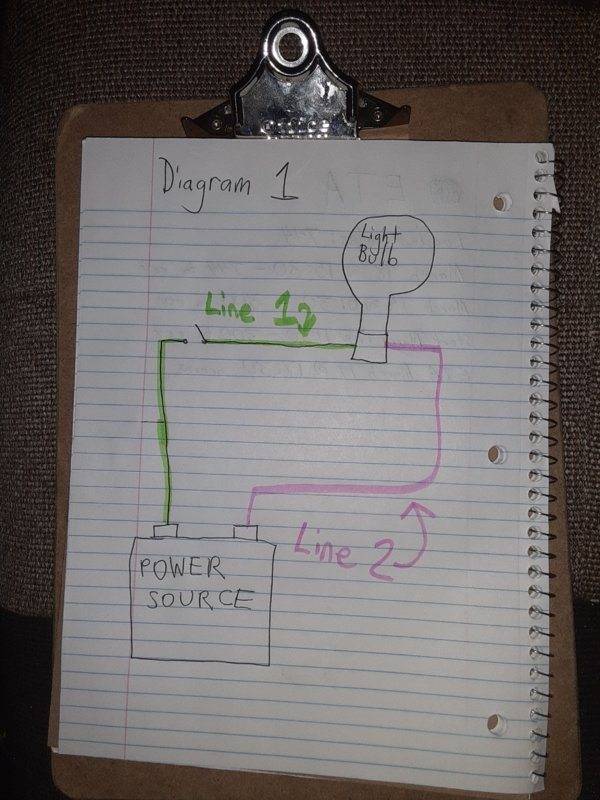

I know that on an alternating current circuit, you have to have both a line 1 and a line 2 to have a circuit. Here is a pictorial diagram of an alternating current circuit:
Diagram 1 is the diagram in the photograph posted above. Notice how in diagram 1 you have a line 1 in green, and there is a line 2 after the load in pink. I know that if the switch was closed in diagram 1, alternating current would flow in the circuit, and the light bulb would light up.

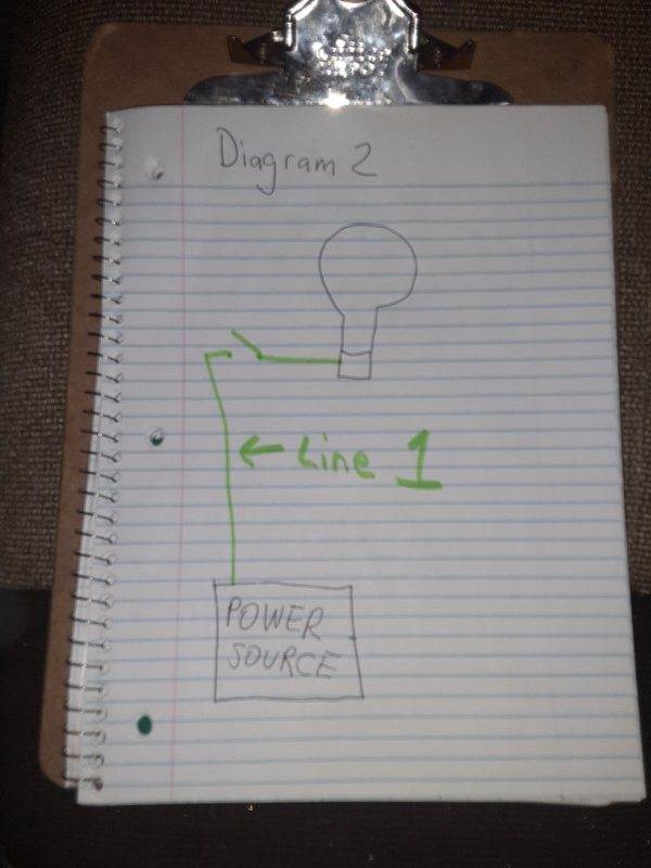

Why would an alternating current circuit like in Diagram 2 not work? Here is diagram 2:
If I closed the switch in diagram 2, why would alternating current not flow from the power source to the light bulb and then back to the power source? Since the direction of the alternating current switches back and forth sixty times per second with 60hz power, why couldn't the power flow from the power source to the light bulb for 1/60th of a second, light up the light bulb, and then flow back to the power source using the same wire in the next 1/60th of a second? I know that diagram 2 would not function as a circuit. I know that there would have to be a line two going from the load back to power for there to be a circuit. My question is: Why does one need a line 2 to make a circuit?
Current will only flow if there is a closed circuit. Doesn't matter whether it's AC or DC, that's always true.
Electric power is not like water. Power is voltage times current. Current alone does not make power. So stop thinking of power flowing like water in a pipe.
Another way to look at it is this. Current does not leave the power source on line 1 unless the same amount of current returns to the power source on line 2 instaneously. So no current flows through a wire with two dead ends.

A potential difference requires a potential subtraction = two different voltages.
The differential voltage from the two terminals of the power source must reach the light globe terminals, then a current can flow through the light globe. The product of the differential voltage and the current is power.

There MUST be a complete circuit, your diag 1 shows that
Your diag 2 is not a complete circuit. It's only half a circuit
There must be a go and a return line

This seems like an awful lot of hubbub about a very simple answer. Let's look at the OP:
timmeister37 said:
Summary:: Why cannot AC go back and forth on an AC circuit on the same line?
The answer is that in the real world a tiny current will flow. But as soon as the charge builds up at the far end it will diminish the flow (almost to nothing), unless you carry that charge away. This requires the other wire and that charge must in fact end up back at the source one way or other. Otherwise no useful current. Finis

OK, I see how you are interpreting it. By the way, power does NOT leave the source. CURRENT leaves the source and it creates power at the load. At the same time, the generator generates power to satisfy the current demands of the load. What move through the line is current, not power.
Think of current as a bicycle chain. It either all moves or none of it moves.
