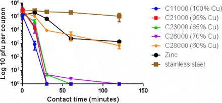

A study on metal surfaces - stainless steel, pure copper, and a few alloys
https://aem.asm.org/content/81/3/1085 ( 2014 )
A previous study in our laboratory observed that dry copper and copper alloy surfaces rapidly inactivated MNV-1 and destroyed the viral genome. In this new study, we have observed that a relatively small change in the percentage of copper, between 70 and 80% in copper nickels and 60 and 70% in brasses, had a significant influence on the ability of the alloy to inactivate norovirus ... We have previously shown with a small range of copper alloys the rapid destruction of murine norovirus (MNV), a close surrogate for the human norovirus causing gastrointestinal disease, which is necessary because of the lack of a suitable infectivity assay for the human norovirus
Norovirus had the ability such that most cleaning agents are ineffective against it, and can be viable for up to weeks a wide range of common surfaces.
Depending upon the copper alloy it would seem, and the corrosive species.
After 30 minute contact, a surface of pure copper was effective in destruction , with "efficacy of these brasses in inactivating norovirus is directly proportional to the copper content".
FIG 4
Persistence of MNV infectivity on brasses. Approximately 5 × 105 PFU of infectious virus was applied to 1-cm2 samples of test surfaces and incubated at room temperature. At various time points, virus was removed from the surfaces and assessed for infectious virus by plaque assay as described in the text. The efficacy of these brasses in inactivating norovirus is directly proportional to the copper content; 100% Zn appeared to have some antiviral activity, similar to that of Muntz metal (C28000). The possible antiviral effect of zinc is discussed in the text.
The appearances of these alloys are very different: C72500 is very shiny and polished compared to the dull alloy C70600. This may be due to a passivating oxide layer, which may contribute to efficacy (this alloy is employed in marine engineering because of excellent antifouling properties). Hans et al. (24) reported that a layer of cuprous oxide (Cu2O) was as effective at killing Enterococcus hirae as pure copper but found that copper II oxide, CuO, is inhibitory by forming a protective layer that reduces the rate of corrosion (passivation layer). We observed that if the surfaces of alloys C70600 and C72500 were abraded by rubbing with coarse sandpaper (Fig. 3A), the efficacy of the former to inactivate MNV-1 was reduced following 30 min of contact at room temperature (Fig. 3B). This suggests that the presence of an oxide layer on this alloy contributes to its antiviral efficacy.
Note: I find it difficult to correlate this prose with the suggested figure 3B, regarding ally C72500. ie CuO and Cu2O corrosion, abrasion of the surface, and efficacy of the metal surface.
Although the reference 24 Abstract does suggest that the oxide Cu2O, that forms under normal conditions is as effective as a pure copper surface, with a CuO surface not as effective as either.
CuO was found to significantly inhibit contact killing, compared to pure copper. In contrast, thermally generated Cu2O was essentially as effective in contact killing as pure copper. Copper ion release from the different surfaces roughly correlated with their antibacterial efficacy and was highest for pure copper, followed by Cu2O and CuO. Tris-Cl induced a 10-50-fold faster copper ion release compared to PBS. Since the Cu2O that primarily forms on copper under ambient conditions is as active in contact killing as pure copper, antimicrobial objects will retain their antimicrobial properties even after oxide formation

256bits said:
After 30 minute contact...
As far as I know for hospital grade disinfectants the required 'kill time' typically measured in seconds, but at (very) few minutes at most and any surface where the stuff is applicable included.
30 minutes to kill, and you can touch it with bare hands? That's what 'mild' means.
