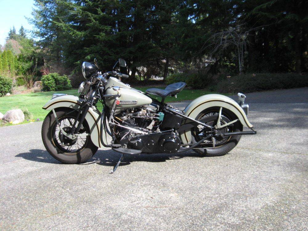

I'll go you one better.
No suspension on the rear wheel, and laughably little on the front, with a set of springs but no shock. Rear tire is fairly low pressure, at about 20 psi. The saving grace is that seatpost is sprung, and takes up a lot of the bumps. This is my 1948 Harley Davidson FL, common referred to as a Panhead.
