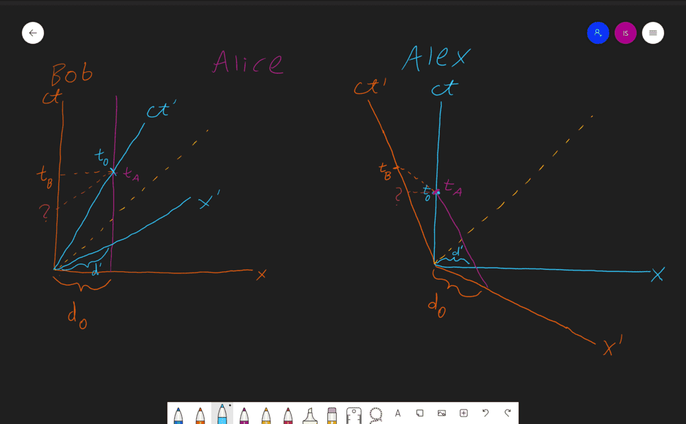

From all the answers I realize that there are inherent problems in the nature of the experiment. There is one point I do not understand:
Alternatively, we can assume that Alex is motionless while Bob and Alice are on the move. In this view of the experiment, Bob overtakes the immobilized Alex. When Alice approaches Alex, then Alex photographs his own watch and Alice's watch and then accelerates to be able to accompany Alice on her journey. Shouldn't the photographed watches now show that Alice's time is slower?
1. If the answer is yes, then this contradicts the previous result. But this is impossible because we are not referring to two different experiments but to two different perspectives of the same and unique experiment.
2. If the answer is no, then why? are the two reference systems not symmetrical?
The answer is no. The scenario is not symmetrical because you have two people at rest in one frame and the relativity of simultaneity applies. Bob and Alice's watches are not synchronised in Alex's frame.

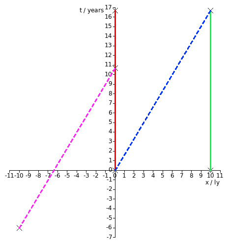

It's not a matter of lack of accuracy. It is a matter of not all inertial frames agreeing that t Bob's and Alice's clocks were ever synchronized to each other.
Imagine two other observers who, before Alice and Bob tried to sync their clocks, were already in motion with respect to Bob and Alice. Carl is moving in the Bob to Alice direction, and David in the Alice to Bob direction. Let's say that they both have a speed of 0.5c relative to Bob and Alice.
Bob sends his signal.
From Carl's frame, Both Bob and Alice are moving at 0.5c relative to him, with Alice "chasing after" Bob.
One of the key ideas of SR is that light (in a vacuum) travels at c in all inertial reference frame, regardless of the velocity of the source. What this means is that Carl must measure the signal spent by Bob as moving at c relative to himself. So, according to him Alice is rushing to meet Bob's signal. and the they are closing in on each other at 1.5c.
For David, Bob and Alice are also moving at 0.5c, but with Bob chasing after Alice. He must also measure the signal as traveling at c relative to himself and thus Alice is running away from the signal, so that the closing speed between them is only 0.5c.
The upshot is that for Carl, less time passes between the signal leaving Bob and arriving at Alice than does according to David. Both will agree on the distance between Bob and Alice, and how much time passes between Bob emitting the signal and his setting his local clock to 0.

So, let's consider Alex. We'll assume that he, after accelerating will pass Bob moving at 0.5c (so now he is at rest in the same inertial frame as Carl.)
According to both Bob and Alice, Alex passes Bob when both of their clocks read some time T, and he will arrive at Alice when both clocks read T+2 yrs. Alex's clock, having undergone time dilation will have advanced 1.732 years (If we assume that Alex matched his clock to Bob as he passed, then his clock will read T+ 1,732 yrs when he meets up with Alice). Thus according to them( Bob and Alice), less time passed Alex during the trip than did for either of them.
Now let's look at the same events according to Carl.
He and Alex are at rest with respect to each other, thus their clocks tick at the same rate. Bob's and Alice's clocks are moving at 0.5c, and their clocks are time dilated at a rate of 0.866. The distance between Alice and Bob is also length contracted to 0.866 ly. In addition, as covered above, Bob's and Alice's clocks are not in sync. But will be offset from each other by 0.5 yr with Alice's clock reading later. (If Alex passed Bob when Bob's clock reads T, Alice's clock will already be reading T+0.5y).
At a relative speed of 0.5c it will take 1.732 yrs from the moment Bob and Alex pass and Alex and Alice meet. So this is how much time Carl will measuring passing for Alex.
Both Bob's and Alice's will be seen as time dilated, so Carl will measure 1.732 x 0.866 = 1.5 years passing for them. Since Alice's clock already read T+0.5 years when Alex was next to Bob, Alice's clock will read T+2 yrs when she and Alex meet up. ( Thus according to Carl, Bob's clock reads T+1.5 yrs When Alex meets up with Alice.)
So Bob, Alice and Carl will all agree that Bob's and Alex's clocks both read T when they passed each other, and that Alex's clock read T when passing Bob, and T+1.732 yrs while when meeting Alice' s clock, and that Alice's clock reads T+2 years when Alex and she meet up. However they will not agree as which clocks ticked faster over the interval between Alex and Bob passing and Alex and Alice meeting, with Bob and Alice saying Alex's clock advanced by 1.732 yr for their 2, and Carl saying that Bob's and Alice's clock advanced only 1.5 years for Alex's 1.732 yr.
This is why a "round trip" is generally used. If Alex goes from Bob to Alice and back to Bob, then we are comparing Just Bob's and Alex's Clock while they are side by side, and everyone, (including Carl*) will agree that Alex will have aged less when they meet up again.
* In this case, while Carl says that Bob ages less during the "Bob to Alice" leg, He we also say that Alex's clock runs much slower than Bob's clock during the "Alice to Bob" leg( during this leg, while Bob's clock runs 0.866 the rate of Carl according to Carl, Alex's clock would run 1/7 as fast as Carl's).

Can someone help me out with the work to solve this problem relativistically (such as guidance on drawing the Minkowski diagrams or working out the relevant spacetime intervals)? I’m trying to relearn relativity (it’s been over a year since I last did a problem like this and I can’t seem to get a grasp on this situation). I don’t know if I should make this a new thread or not.
I don't think it needs to be a new thread, since a more detailed working of the problem might help the OP in this thread.
I would recommend picking a speed for Alex relative to Alice and Bob (@Ibix recommended two good choices in post #2), working in Alice's and Bob's common rest frame, and choosing the spacetime origin ##(x, t) = (0, 0)## to be the event where Alex passes Bob. Then work out the coordinates of the event where Alex passes Alice, based on Alex's speed and the distance from Bob to Alice in the chosen frame, and calculate the spacetime interval between those events, which will be the time elapsed on Alex's clock between them, using the standard interval formula.
Once you have coordinates of the relevant events in the Bob-Alice rest frame, drawing a spacetime diagram should be easy. If you want to then transform into Alex's rest frame to see how things look there, the standard Lorentz transformation formulas will give you the coordinates of the relevant events in that frame so you can draw another diagram.

  • #33
I drew out the Minkowski diagrams for this situation-- I just wan't to make sure I did this right (note I have color coded the three people on the diagrams)
First, I do know that d0>d', and tA=tB>t0 (right?). My question is on the time I labeled with a ? on both diagrams. If I am correct, that time will be smaller than t0, and will be the time that Alex thinks Bob measures when Alex crosses Alice (i.e. if someone a distance d' behind Alex in Alex's frame, whose clock was zeroed at the same time as Bob's clock, looks at Bob's clock when Alex passes Alice). This would show how Alex believes that Bob and Alice both experienced time dilation, while still maintaining that Alice's clock reads higher than his when they pass. It would also seem like if Alice took a picture of her and Alex's clocks when Alex passes her, her pictures would be the same as Alex's pictures--right?

All the answers claim that the photos show that Alex will be younger than Alice. But we can assume that there is a new person
I am confused now. Please provide a diagram (in any chosen reference frame) showing who is where and when.
