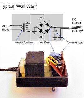

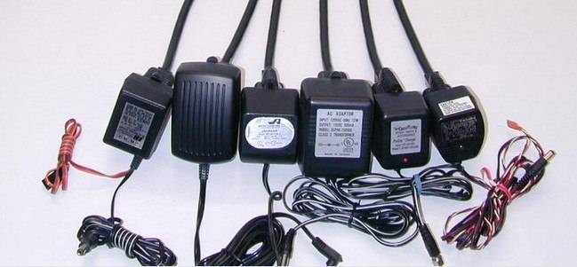

This is very true - as far as it goes. But if you have a house full of devices, some of them could have been installed years ago. It is very possible that there could be a resistive connection from 'one side' of your supply to Earth. No one would know about that; everything would be working fine. However, the 'other side' of your circuit would now have full mains volts on it so you could no longer go ahead and touch it, secure in the knowledge that you would be safe. The value of leakage resistance wouldn't need to be that low, for the 'hot' side to be able to pass a significant enough current to kill you without blowing a fuse.
What you are suggesting is, in fact, done when connecting individual electrical devices in outdoor applications. An isolating transformer with floating outputs is often used and the protection this gives is well worth having. However, the appliances are built to a higher standard of insulation so there is very little chance of the fatal combination of a leakage to ground on one side and an exposed conductor on the other side.

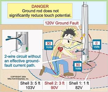

Food for thought. :oldbiggrin:
image compliments of http://ecmweb.com

The reason is real simple.
Stuff happens.
A system that was built ungrounded will not remain ungrounded - something will get wet or a mouse will eat the plastic off a wire.
Then you have a system that's not ungrounded like you think it is and that's dangerous.
So we ground the system. Now an accidental ground will trip the breaker which announces that something needs to be fixed.
That's the basic thought.
For an in depth tutorial look up IEEE Green Book. It is well written and starts with the basics.

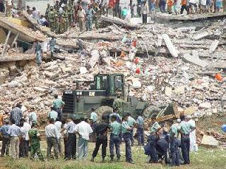

Like many such standards, it exists only because of someone's massive property loss or death.
e.g. who publishes the NEC ? Not the academic IEEE but NFPA, National Fire Prevention Association.
Imagine how the boiler and pressure vessel code came about..

Everything powered by one of these
is powered from a "floating" supply. The system may or may not be earthed. The laptop I'm typing this on is not.

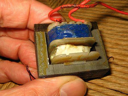

There is minute capacitance between primary and secondary windings, as mentioned.
That's minimized by split-bobbin winding, which also assures that an insulation failure won't let their two wires touch.
Here is a little transformer using a divided (or split) bobbin. This is very practical, because it completely separates the primary from the secondary winding, making it much easier to achieve the degree of insulation required for safety.
http://ludens.cl/Electron/trafos/trafos.html
