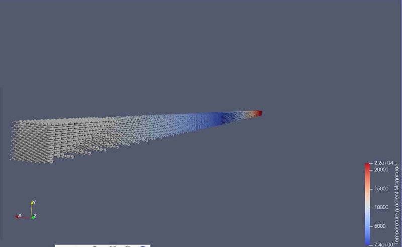

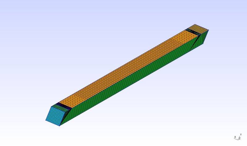

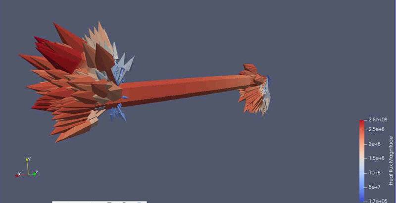

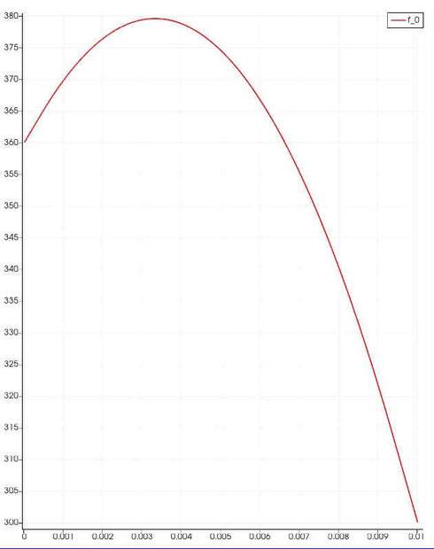

You are missing that the heat engine can do work, so not all the heat from the hot reservoir goes into the cold one.
It may be hard to visualize without a sketch, but here is a possible set up. Place a Bi2Te3 bar between 2 reservoirs kept at different fixed temperatures. The Seebeck effect is going to produce an emf (roughly) worth ##S\Delta T##. This comes from the generalized Ohm's law ##\vec J=-\sigma \nabla \overline{\mu}/e-\sigma S \nabla T## (in open circuit condition, so J equals 0). So it's like a battery in some way. Now you attach a Cu wire (whose Seebeck coefficient S is near 0V/K compared to the Bi2Te3 one) near the top and the bottom (say near the 2 reservoirs, but you're not obliged too. At the junctions there will be heat released/adsorbed), to close the electric circuit. You can assume this Cu wire has a resistance Rload. The electric current going through the TE material and the Cu wire is ##I=S\Delta T/(R_{TE}+Rload)=A|\vec J_e|## where A is the cross section area.
Now if you look at the heat flux ##\vec J_Q=-\kappa \nabla T +ST\vec J_e## in the Bi2Te3 material, and look for the condition where it flows against the ##-\nabla T## direction, you'll get that (in the case where Rload is negligible compared to ##R_{TE}##, which is feasible in practice) ##ZT>1## where Z is the usual thermoelectric figure of merit. Bi2Te3 satisfies this condition near room temperature. I have no time to show you the math, but it's extremely easy to do.
Note that there is no Peltier effect right at the reservoirs/Bi2Te3, since there is no electric current through the reservoirs. The Peltier effect manifested as heat released/absorbed is at the Cu/Bi2Te3 junctions.
Things are in reality severely more complicated though, the end result is that one can make almost anything one can imagine (to open a can of worms and wormholes, one should consider the Thomson effect whenever a current and a thermal gradient coexist, as in our case, and we can tune the temperature gradient to our likings, and hence the Thomson heat released/adsorbed locally to our liking. But that's only the visible scratch. Researchers have overlooked other thermoelectric effects that exist, but are not reported in the literature yet. I will not go there, this is not allowed in this forum).
