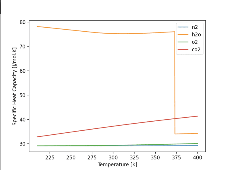

This is a plot of the heat capacities of N2,O2,CO2 and H20 versus temperature, for a pressure of 5 bar:
I thought we were going to operate this at 1 bar, like in the paper.
casualguitar said:
The N2 and O2 heat capacities are almost identical (I don't think we have discussed the inclusion of O2 in this model however I've included it here). The CO2 heat capacity is also very similar to N2/O2 while in the gas phase. H20 heat capacity is not similar to the others however if N2/O2/CO2 take up a high enough mass fraction of the total mixture then this constant molar heat capacity assumption seems reasonable
Your curve for water vapor is wrong. The molar heat capacity of water vapor is about 36 J/mol-K. We are interested only in the heat capacities in the gas phase for this model. At 1 bar, we are talking about the ideal gas heat capacities which are all functions only of temperature.
casualguitar said:
The CO2 heat capacity will jump up when it transitions to solid phase. This plot however is actually the correlation used for the liquid phase (as thermo does not recognise solid CO2 it uses the liquid correlation instead). We can manually add solid correlations where needed. It doesn't look like we will need one here though given the constant molar heat capacity assumption
We are not assuming constant molar heat capacity. The temperature dependence of the heat capacities should be included in the model. We are only assuming negligible effect of composition (i.e., changes mole fraction).

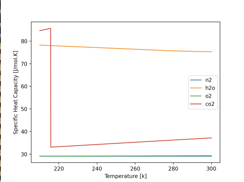

Well yes the molar heat capacity of water vapor is about 36 J/mol.K in the vapor phase. Actually I hadn't thought about the phase of water entering the bed. If we are dealing with combustion gases then the temperature will surely be in the vapour range for water. However water won't desublimate like CO2 will at atmospheric pressure so it seems we would have an intermediate liquid phase
Heat capacity including the vapour phase for water:
The model assumes that condensed water is all immobilized on the bed. You can see from their model plots that most of the water is released again to the gas phase before the CO2 begins accumulating on the bed (so there is not significant interaction, according to their results).

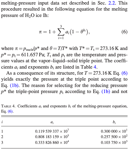

CO2 will solidify at a temperature below the freezing temperature of the water so we will see solid phase water. So are we saying that liquid and solid phase water are both immobilised on the bed, and that both of these phases would be accounted for in the water mass balance?
No. See their Fig. 3.

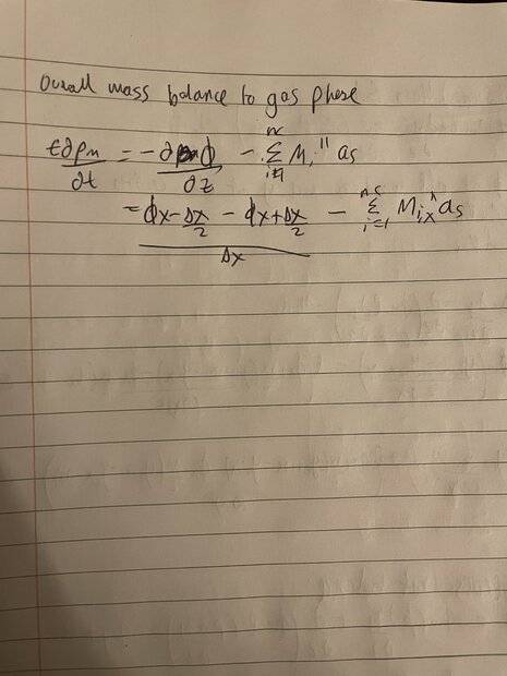

On a mole basis, the overall mass balance equation for the gas phase will read: $$\frac{\partial (\epsilon \rho_m)}{\partial t}=-\frac{\partial (\rho_mv_m)}{\partial z}-\sum_{i=1}^{n_c}{\dot{M}_i^"a_s}\tag{1}$$where ##\rho_m## is the molar density of the gas $$\rho_m=\frac{P}{RT}\tag{2}$$ ##v_m## is the superficial molar flow rate, and ##\dot{M}_i^"## is the molar deposition rate of species i per unit area of bed. Note from Eqn. 2 that the molar density of the gas (assumed ideal) does not depend on the composition of the gas (i.e., the mole fractions of the various species), but only the absolute temperature.
TO BE CONTINUED
  • #41
TO BE CONTINUED
Followed fully. No questions on this

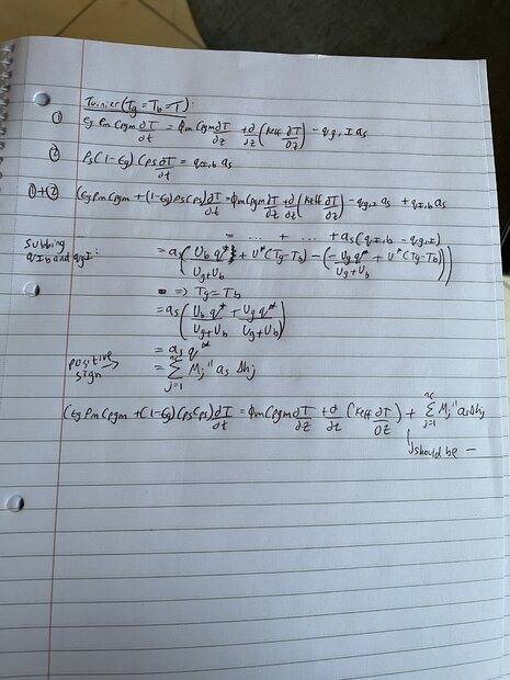

Ok so is it reasonable to say that the main two reasons for going with this approach are:
1) It avoids using the simplification that the bed and fluid are at the same temperature
2) It 'aligns' this model with the old one i.e. they will both use a similar 'tanks' approach
Splitting the left side of the heat balance seems straightforward. The right side not so much. The split will possibly look something like this:
$$\epsilon_g\rho_g C_{p,g}\frac{\partial T_f}{\partial t} = -\rho_gv_gC_{p,g}\frac{\partial T_f}{\partial z} - \sum_{i=1}^{n_c}{\dot{M}_i^"a_s}\Delta h_i + Ua_s(T_s-T_f)\tag{5}$$
$$\rho_s(1-\epsilon_g)C_{p,s}\frac{\partial T_s}{\partial t} = \sum_{i=1}^{n_c}{\dot{M}_i^"a_s}\Delta h_i + Ua_s(T_f-T_s)\tag{6}$$
Where U is the gas solid heat transfer coefficient in W/m2.K
My rationale for the above equations being:
1) The fluid will have an energy contribution from the solid now (the last term in the fluid heat balance)
2) The solid will not have a convection term associated with it
3) The solid will have an energy contribution from the fluid (equal and opposite to the fluid-solid energy contribution)
4) The 'phase change' term is an energy transfer between the fluid and solid so it will be present in both equations (and equal and opposite)
I did not know what to do with this term ## \frac{\partial}{\partial z}(\lambda_{eff}\frac{\partial T}{\partial z})##. Previously we lumped this term in with the fluid-solid heat transfer coefficient U, so in the interest of making these equations similar in style to the old model I did that here also

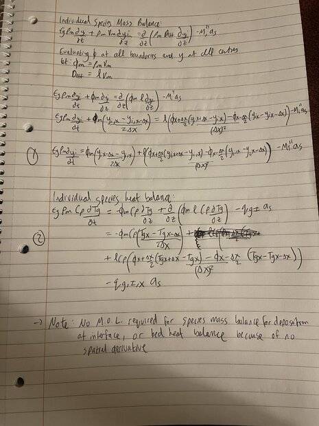

Individual Species Mass Balance Equation for Gas Phase in Terms of Molar Quantities
$$\epsilon_g\rho_m\frac{\partial y_i}{\partial t}+\rho_m v_m\frac{\partial y_i}{\partial z}=\frac{\partial}{\partial z}\left(\rho_m D_{eff}\frac{\partial y_i}{\partial z}\right) -\dot{M}_i^"a_s$$$$+y_i\sum_{j=1}^{n_c}\dot{M}_j^"a_s\tag{5}$$where ##y_i## is the mole fraction of species i in the gas phase.
I'd now like to talk about how I would change the model if I were in charge (hopefully to improve it). Of course, in this project, you are in charge and the final decisions on all aspects of the work are up to you.
In the heat balance, I would have separate temperatures for the gas and the bed (##T_g## and ##T_b##) and a separate heat balance for each of them. The two heat balances would be linked by the balance for heat flows into and out of the interface: $$q_{g,I}+\sum_{j=1}^{n_c}\dot{M}_j^"\Delta h_j=q_{I,b}\tag{6a}$$where the heat fluxes from the gas to the interface ##q_{g,I}## and from the interface to the solid bed ##q_{I,b}## are given by $$q_{g,I}=U_g(T_g-T_I)\tag{6b}$$ and $$q_{I,b}=U_b(T_I-T_b)\tag{6c}$$with ##T_I## representing the temperature at the interface (deposit), and where ##U_g## and ##U_b## represent the effective heat transfer coefficients between the bulk gas and the interface, and between the interface and the solid bed, respectively. These would be determined by the heat transfer correlations for packed beds from Bird, Stewart, and Lightfoot that we are using in the tanks model.
If we solve Eqns. 6 for the temperature at the interface, we obtain: $$T_I=\frac{\sum_{j=1}^{n_c}\dot{M}_j^"\Delta h_j}{U_g+U_b}+\frac{U_gT_g+U_bT_b}{U_g+U_b}\tag{7}$$From this it follows that the heat flux from the gas to the interface is given by: $$q_{g,I}=-\frac{U_g\sum_{j=1}^{n_c}{\dot{M}_j^"\Delta h_j}}{U_g+U_b}+U^*(T_g-T_b)\tag{8}$$ where U* is the overall heat transfer coefficient: $$\frac{1}{U^*}=\frac{1}{U_g}+\frac{1}{U_b}$$
Similarly, the heat flux from the interface to the solid bed is given by: $$q_{I,b}=+\frac{U_b\sum_{j=1}^{n_c}{\dot{M}_j^"\Delta h_j}}{U_g+U_b}+U^*(T_g-T_b)\tag{9}$$
Thoughts?

Lots of questions on this one
Why is the last term included here? The second last term is the total moles of species i deposited on the bed. The last term seems to be the total amount of all other species deposited on the bed. But if this is the case, why would we have more than one species considered in the same mass balance? Are these not going to be considered in their own mass balances?
I notice here that the convective and diffusive terms have opposing signs. Why is this? Is this a convention?
Agreed. This would make the formulation more similar to what we had in the previous model, and also avoids the assumption of ##T_g = T_b##
What is the 'interface' defined as? As far as I understand its the zone around a solid particle in the bed, where the gas changes phase and is deposited as a solid. Is this correct? If so then 6a, 6b and 6c all make sense to me
Thoughts?
Brilliant, fully followed so far
Thoughts - so there are time and position derivatives clearly present in the species mass balance. Currently we're dealing with heat flux terms ##q_{I,b}## and ##q_{I,g}## on the heat side which are not currently time or space dependent. I'm not sure if this is a natural way to go about developing the model, but it seems to me like we should try to 'put' the time and space derivates in somehow. How would these heat flux terms be tied back into a heat balance that is time and space dependent?
Also - looking at my previous response, I took the approach of manually 'splitting' the solid and gas heat balance. Ignoring the fact that my equations are likely incorrect, is this approach also ok?
Edit: I haven't done the solution out myself for eqs 7,8,9 yet so I'll work through that this evening
  • #46
We discussed this when we talked about the comparison between the divergence form of the species mass balance and this equivalent form of the species mass balance. We noted that the divergence form has only the single species deposition term. This form is obtained by multiplying the overall mass balance by the mole fraction yi, and subtracting the resulting equation from the divergence form of the mass balance. That leads to the term you are referring to. There is nothing wrong with any of these equations.
Yes, terms like this are included in all the species mass balances when expressed in this non-divergence form.
You had no problem with this in the heat balance equation, where the thermal flux is proportional to minus the temperature gradient; why do you have a problem now where the mass flux is proportional to minus the mole fraction (concentration) gradient.
I envision it the same as if the solid and liquid deposition is an extremely thin layer at the solid bed surface, and is the same as if it were just absorbed (vanished) at the bed surface; so its only effect is the release of heat at the interface between the gas and the solid bed.
There are no space and time derivatives because the amount of mass involved is negligible. You don't seem to have this same problem in the formulation of the other model when we express the heat flux between the air and the bed as ##U(T_a-T_s)##. The equations I've written here are not the full heat balances. They just give the heat fluxes to the gas and the bed. They must be combined with the accumulation and dispersion terms to give the full heat balances for the gas and the bed. This is what I'll write down next.
I don't know what you mean.

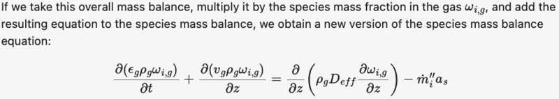

Terminology - For me when we say 'individual component mass balance' (as used in post 27) means the same thing as the 'species mass balance'. Is this correct?
Rationale - so the overall mass balance tracks the total amount of gas, and the total amount of solid. We took this overall mass balance and multiplied it by ##y_i##. Then we took the divergence form of the mass balance, which only deals with a single component, and subtracted the overall mass balance from this, which leads to equation 5. Two questions I think will fully clear this up:
1) What is the advantage of subtracting one from the other? (Or why do this?)
2) Does that last term in equation 5 have any physical meaning, or does it just arise as a result of doing the above?
yes
Because the original derivation of the species mass balance resulted in the divergence form of the equation which did not give the partial derivative of the mole fraction with respect to time directly. By manipulating to the non-divergence form, we get the partial derivative of the mole fraction with respect to time directy.
In my judgment, the latter.
casualguitar said:
Ah ok. I was trying to visualise an element where you have an accumulation of mass over time (term 1 in eq.5), mass entering due to convection (term 2), mass entering due to diffusion (term 3), and mass leaving the gas phase due to deposition (term 4). I can absolutely see that mass flux would be proportional to minus the concentration gradient. Does this also mean that the convective term is proportional to minus the diffusion term?
No. You can see that there are other terms in the equation as well.
casualguitar said:
Got itYes I didn't have this same problem because we had a time derivative on the LHS and also had used the method of lines for the spatial domain so in effect we did have position and time built in.
Ah understood, yes when they heat fluxes are combined with the accumulation/dispersion term I think this will sit with me a lot better.
Actually also I don't have your understanding of the road ahead i.e. where the model is going to next (in this case finishing off the heat balance seems to be the next step but I would not have known this myself). I think having this vision or 'map' of the road ahead in a sense would make each step feel a lot more natural as I would know why its happening. So because I don't have this (I think this will come with time!) I am much better able to connect the dots of the model in reverse i.e. I can see why you make a certain step after the next step is made in the model.
So yes I think finishing out the heat balance out will possibly clear up the rationale behind the steps we have taken so far leading up to it, if this makes sense

Just one possible sign error:
After checking that this model is the same as the Tuinier model once ##T_g=T_b=T##, I found that the solid deposition term was positive (rather than negative as is it is in the Tuinier model). Is there an error in what I have done, or is it possible that the definition of q* should be a negative term i.e. $$q^*=-\sum_{j=1}^{n_c}{\dot{M}_j^"\Delta h_j}$$
Besides this I am very much ok so far on this
Edit: Also, the next step I would guess is to discretise the spatial domain using the method of lines?
It's got to be a typo in the Tuinier paper. If mass is building up at the interface, then heat is being released.

  • #62
The finite difference scheme employs a finite difference grid with spacing ##\Delta x##, grid cell boundaries at ##(z=0,\ \Delta z,\ 2\Delta z...)##, and grid cell centers at ##(z=\Delta z/2,\ 3\Delta z/2,\ 5\Delta z/2,\ ...)##. The mass flux into the bed ##\phi_0## is known at the cell boundary z = 0, and we calculate the mass flux at all the other cell boundaries. On the other hand, we calculate the fluid temperatures, enthalpies, and densities at the cell centers.
These are the individual species mass and heat balances, and the overall mass balance to the gas phase, the equations with spatial derivatives. Its just the first step though (haven't subbed out ##l## yet). All ok so far?
If these three equations look ok I'll let ##l = \Delta z/2## in the morning. Quite a long train journey ahead tomorrow, so plenty time for some calculations
Note: I have written x in the FD scheme. I should have used z. I will rewrite this in the next iteration
  • #63
I can't read your handwritten version. Please just present the results using LaTex. Thanx.
  • #64
Here are the three equations with spatial derivatives (I have not subbed ##l## out yet or simplified, this is just the first run through).
Note: Given that these all deal with species i only I have left the i subscript out of this version for brevity
Individual species mass balance:
##\epsilon_g\rho_m\frac{\partial y_i}{\partial t} + \phi_m\frac{y_z - y_{z-\Delta z}}{2\Delta z} = +l\frac{\phi_{z+\Delta z/2}(y_{z+\Delta z}-y_z)-\phi_{z-\Delta z/2}(y_z-y_{z-\Delta z})}{(\Delta z)^2} - \dot{M}_z^"a_s\tag{1}##
Individual species heat balance:
##\epsilon_g\rho_mc_p\frac{\partial T_g}{\partial t} = - \phi_mc_p\frac{T_{g,z} - T_{g,z-\Delta z}}{2\Delta z} +lc_p\frac{\phi_{z+\Delta z/2}(T_{g,z+\Delta z}-y_z)-\phi_{z-\Delta z/2}(T_{g,z}-T_{g,z-\Delta z})}{(\Delta z)^2} - \dot{M}_z^"a_s - q_{g,I,z}a_s\tag{2}##
##\epsilon_g\frac{\partial \rho_m}{\partial t} = \frac{\phi_{z-\Delta z/2} - \phi_{z+\Delta z/2}}{\Delta z} -\sum_{i=1}^{n_c}{\dot{M}_z^"a_s}\tag{1}##
If these look alright to you I'll sub in for ##l## and simplify
  • #65
For these terms, I think you meant to write the following 2nd order approximations:
$$\phi \frac{\partial y}{\partial z}=\phi_z\left[\frac{y_{z+\Delta z}-y_{z-\Delta z}}{2\Delta z}\right]$$
$$\phi C_p \frac{\partial T}{\partial z}=\phi_zC_{p,z}\left[\frac{T_{z+\Delta z}-T_{z-\Delta z}}{2\Delta z}\right]$$
The 2nd order finite difference approximations I am recommending lead to much more attractive and compelling results in the final finite difference equations:
$$\phi \frac{\partial y}{\partial z}=\frac{1}{2}\left[\phi_{z+\Delta z/2}\left(\frac{y_{z+\Delta z}-y_z}{\Delta z}\right)+\phi_{z-\Delta z/2}\left(\frac{y_z-y_{z-\Delta z}}{\Delta z}\right)\right]$$
$$\phi C_p \frac{\partial T}{\partial z}=\frac{1}{2}\left[\phi_{z+\Delta z/2}C_{p,z+\Delta z/2}\left(\frac{T_{z+\Delta z}-T_z}{\Delta z}\right)+\phi_{z-\Delta z/2}C_{p,z-\Delta z/2}\left(\frac{T_z-T_{z-\Delta z}}{\Delta z}\right)\right]$$
$$l\frac{\partial}{\partial z}\left(\phi\frac{\partial y}{\partial z}\right)=\frac{l}{\Delta z}\left[\phi_{z+\Delta z/2}\left(\frac{y_{z+\Delta z}-y_z}{\Delta z}\right)-\phi_{z-\Delta z/2}\left(\frac{y_z-y_{z-\Delta z}}{\Delta z}\right)\right]$$
$$l\frac{\partial}{\partial z}\left(\phi C_p\frac{\partial T}{\partial z}\right)=\frac{l}{\Delta z}\left[\phi_{z+\Delta z/2}C_{p,z+\Delta z/2}\left(\frac{T_{z+\Delta z}-T_z}{\Delta z}\right)-\phi_{z-\Delta z/2}C_{p,z-\Delta z/2}\left(\frac{T_z-T_{z-\Delta z}}{\Delta z}\right)\right]$$
If we are considering the temperature dependence of heat capacity in the analysis,, then ##C_{p,z+\Delta z/2}## refers to the heat capacity at ##(T_z+T_{z+\Delta z})/2## and ##C_{p,z-\Delta z/2}## refers to the heat capacity at ##(T_z+T_{z-\Delta z})/2##.
