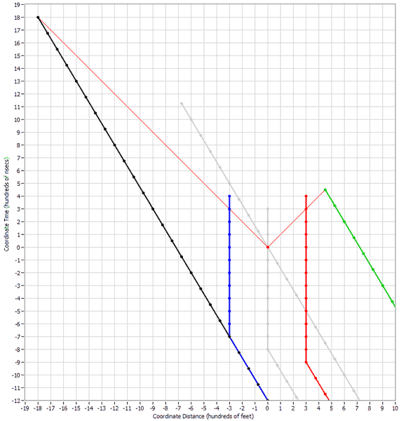

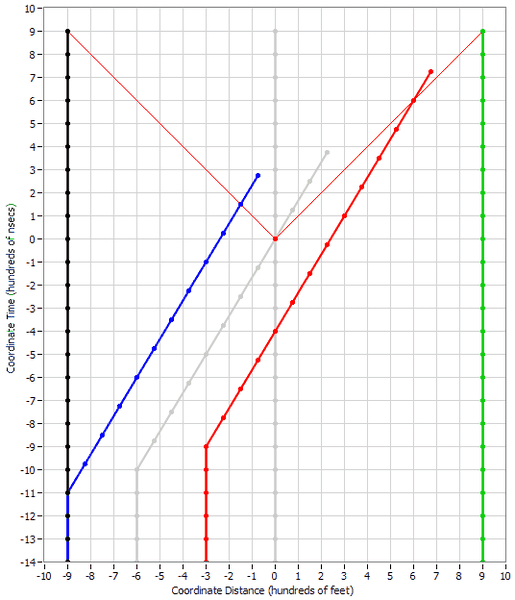

For a spherical wavefront the emission/absorption looks something like this. The light is the sphere emitted by the botton dot and absorbed by the top dot which moves wrt to the emission point. The light appears in the stationary frame to have traveled diagonally.
http://www.blatword.co.uk/space-time/wavemove.mpeg
The light reached the moving top dot after it reached the stationary one, so it covered more space in more time, where is it that "the time slows down"? If I were in the rocket why wouldn't I be able to tell that it took longer to complete one period?

The movement of the light source is irrelevant. See:
http://en.wikipedia.org/wiki/Emission_theory#Refutations_of_emission_theory

As long as the light can reach the mirror and bounce back in the rest frame of the light and mirror - then it will do this in all frames, whatever is done to the light.
As you no doubt know, the light hitting the mirror is an event, the meeting of the worldline of the light and the worldline of the mirror. Nothing related to motion can un-happen it.

There is no "erroneous" here. Either viewpoint is perfectly valid. When you add the requirement that lightspeed be constant for all observers, you can derive the equations for time dilation and length contraction.
To see the point about both viewoints being valid, imagine two identical rockets with lightclocks, traveling in opposite directions. According to one rocket, its own lightclock is working vertically and the other is working on the diagonal. The other rocket can say the same thing the other way round. Which one is right? There's nothing to choose. Both viewpoints are equally valid.
