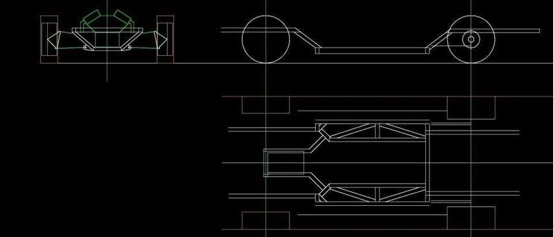

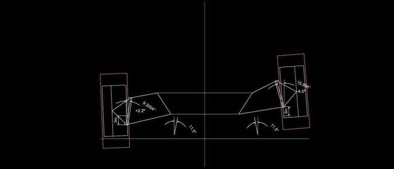

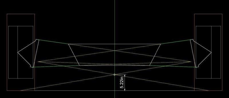

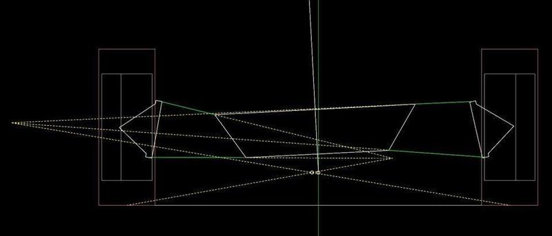

RM - Whew…measuring, changing and re-measuring RC - what a process! But we have been able to get the RC to start out at 3.4" above ground, 2.8" Right. But, I have measured my CL based upon the frame center, and not tire patch. Since I'm running offsets and spacers the tires would cause the CL to shift 1.5" right. Thoughts?
What I have also noticed, by driving change with the software, is that there is a certain rate of change caused by two variables - dive and roll. By "Analyze Suspension" the software is telling me that I should expect 2.3" dive and 1.6* roll. Is there a particular equation I should be looking at?
Also, the software discusses 2 CPS for RF (LF = 0.85RF) and 1.6 CPS for the rear. Steve Smith's Advanced Race Car Dynamics suggests 2 CPS and 1.4 CPS. If I go 'by the book' my RF spring rate will increase to 1163#! This seems way above anything that I've talked to others about.
Right now, based upon my current set up my RF CPS = 1.8, all others = 1.6
If I follow the logic of 1* roll / 1" travel, the RC:
@ 1 = 2.5"H, 5.3"R
@ 2 = 1.7"H, 10.7"R
@ 3 = 0.7"H, 23.0"R
But, if I plug in the MAX dive/roll that the software suggests (2.3" / 1.60*):
RC = 1.5"H, 10.4"R
Finally, my anti dive is: RF = 8%, LF = 5%. This is very close to 'textbook' - 10%, 5%.
It may not look like it (by looking at the car) but we have made several changes. Interestingly enough, we are running the same BJs for the lowers and the same for the uppers. (I would have expected to stagger these.)
I really like the software.

Wow- good job racer! Gives the public an idea just what we do in the winter in a cold garage!
There is a lot to digest. When you use wheel spacers to move the vehicle center line to the right we are adding left side weight. I assume your roll center calculations are based on the final adjusted center line. We try to run as much left side weight as we can get away with. Even used to crank in the ARB (sway bar ) adjuster before rolling across the weight scales.
I am very impressed that you have taken the time to read up on your ideal setup from various source..Excellent.

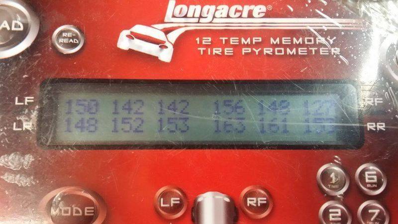

To all racers a word of caution- I swear by using software programs like this one to measure out where the car is and base line it. BUT,,do not get over zealous and start gaming the race car set up. Two huge factors will ruin your ideal set up you have gamed out.
Reality and Aero. All the software in the world can not predict real world things like damper dynamics ( shock action), true spring action, ARB action, and the 32 some moments on a typical stock car. Shocks will heat up and permit more dive/roll during the race. You are burning off weight every lap ( as you eat gasoline). Tires go away from lap 1 on..just the reality of it.
Aero dynamic drag is a lot more problematic and can not be accounted for with this software.
I rely on the software as much as my pyrometer. It is a tool only and should be thought of that way.
On dive and roll, i think you have done a lot of work and should stop.
You have the RC exactly where it should be at static. All the software has indicated it will migrate to the right. I don't really care after 2 inch travel where it ends up as the the max weight transfer has already happened.
Until you can read the shock stops after a hot lap and know actual shock compression, everything else is a guess.
no way will a 1100# spring work.
Good job on anti dive. I think you have taken it as far as you can in the virtual world. Now back to checking rear steer and making sure we don't have suspension bind anywhere. Make sure you do thorough bolt check and get rid of any farm bolts and bolts under grade 8.
you got a real good jump on the competition this year.
rm

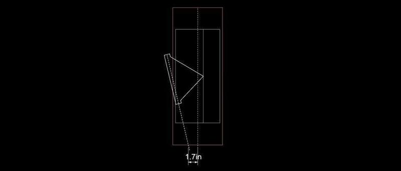

"I assume your roll center calculations are based on the final adjusted center line."
No. If I need to take this into consideration then my RC is 4.3" to the right. If I make any efforts to shift it further left, the RC really starts taking off to the left which will only make the car 'feel like' it has a very soft RF spring. (Which was the case last year.)

At this point I would not monkey with the Roll center location any more. It is migrating where it should. Concentrate on the tire contact patch and look at camber build your actual spindle set up. Use a bump steer gage so you know what it is doing in 2 to 3 inch dive..and on left front too. I would say you have gotten just about all you can out of the software..now it is real world time on new fabricated front end parts..Sounds like you found some major areas to improve!

As a reference, last years RC was 1.9H, 8.5L! The car acted like it had a 2-ton gorilla jumping up and down on a 5-foot torque wrench! It would roll on the Right side severely.

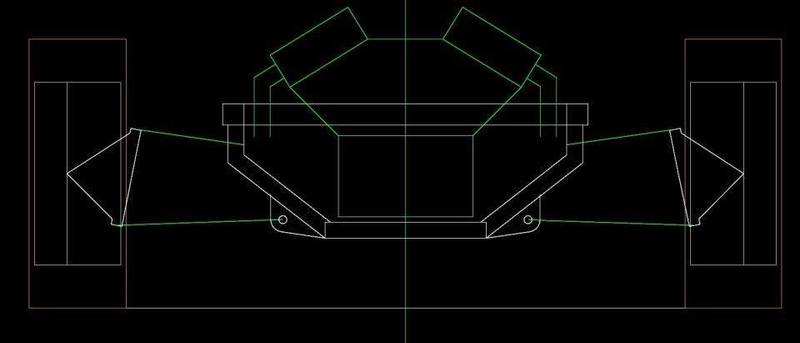

How to measure Ackermann.
If you are into racing and ca n afford it buy some turn plates for $750.00 see photo. Or buy some wax paper and a cheap plastic protractor. Use a straight edge and mark a zero line on the garage floor on the RF and lf tires when the car steering is centered. Crank the RF to the left 18 degrees and mark a line on the floor. Use the straight edge to mark the line where the lf tire is pointing. This is the Ackermann you have in the car.
How much Ackermann?
The left has to steer 15 % more than the right front. A typical asphalt track car needs 3 to 4 degrees more Ackermann on the left front in 18 degrees for right front steering. You crank the wheel to the left and hopefully you get 21 to 22 degrees.
One way to gain Ackermann is with BUMP STEER. For short track asphalt cars we want zero bump on the left front. No bump at all in compression or dive and rebound. Right front we need 0.035 to .040 “bump. Don’t forget the right front is the steering tire. The deeper you go into the turn the more bump you have. As the right front bumps to toe out the more you can steer to the left without pushing.
Whatever you do...do not change one the length of one steering arm on one spindle. It will really mess up the whole steering parallelogram.

If I may ask another race car suspension question, what is the typichal camber gain in an indycar/champcar racer for road and oval courses? Given how little they seem to roll, is that even noticeable and important? The huge amount of static camber coupled with the little roll and small suspension travel (Around one inch IIRC) leads me to think the parameter is not really important and probably sacrificed to aero, but still would like to know -if anyone can share some knowledge.
  • #663
welcome Al..in my opinion it is all about the tire contact patch and camber build is the enemy..looking at it from a designers point of view if you have unlimited funds and can do it go with the longest control arms and make them parallel

Firstly, camber gain and static camber are not the same thing.
Static camber is the angular misalignment of the tires center line from a vertical plane when stationary measured in degrees.
Camber gain is the change in camber with changing geometry or put simply thru bump or droop and is measured in degrees per inch movement.
I think we are talking mostly about static camber and formula cars do not have much built in camber gain.
Camber gain is the change in camber with ANY change in geometry. For most front suspensions two things effect camber gain.
Steering linkage itself by cater change and the resultant scrub effect ( think go-cart steering).
Suspension linkage and related geometry. ( think dynamic).
From what I have seen formula cars do not seem to have much camber gain from either.
Camber gain is generally obtained by unequal A-arm suspension, but even equal length arms differently angled can provide camber gain.
Unequal and non parallel links are the compromise.
Formula cars tend to have fairly parallel control arms on the front suspension. Very much inclined, but fairly parallel to each other.
Suspension travel on a formula car is relatively quite small with how stiff the car is for aero so to some degree camber change with jounce is going to be small even with some non-parallelism.
Before Nascar started to regulate the dimensions of the suspension components, some teams ran a lower A-arm which was very short which gave them a HUGE camber gain from suspension displacement. They had to run a large static camber to compensate. What happens is the tire ends up with some, much smaller, positive camber at race speed when the nose is pushed down by aero.
The tire and resultant heat generated by cornering is the limiting factor in choosing appropriate camber settings. Too much on a stiff tire and you overheat the inside edge, too little on a soft one and you cook the outside. The whole radial/bias ply comparison is pretty useless these days because the regulating organization tells you what tires you can race. So you end up adding camber until you blister the inside edge of your tire and then back it off a degree.
Negative static camber helps keep the tire RELATIVELY vertical during body roll.
Formula cars run very little or even no net negative camber, specially for the inner wheel.
The intent of static negative camber is to land your dynamic camber wherever you want it, which is a non-zero value - several degrees or much more to get the additional cornering force, depending on how much you can get away with your tire.
Dynamic camber build means the inside wheel will get extra negative camber - outside wheel loses some. Since formula cars run such stiff springs your body roll angle and maximum camber gain through cornering is quite small. One downside of camber gain is effect on braking. With dive under braking, camber gain kicks in and compromises the tire contact patch. From my experience breaking performance isn't really affected until you start going over three degrees of negative camber, more or less. Even then you'd have to run like four degrees to notice a subjective difference.
