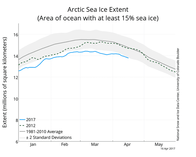

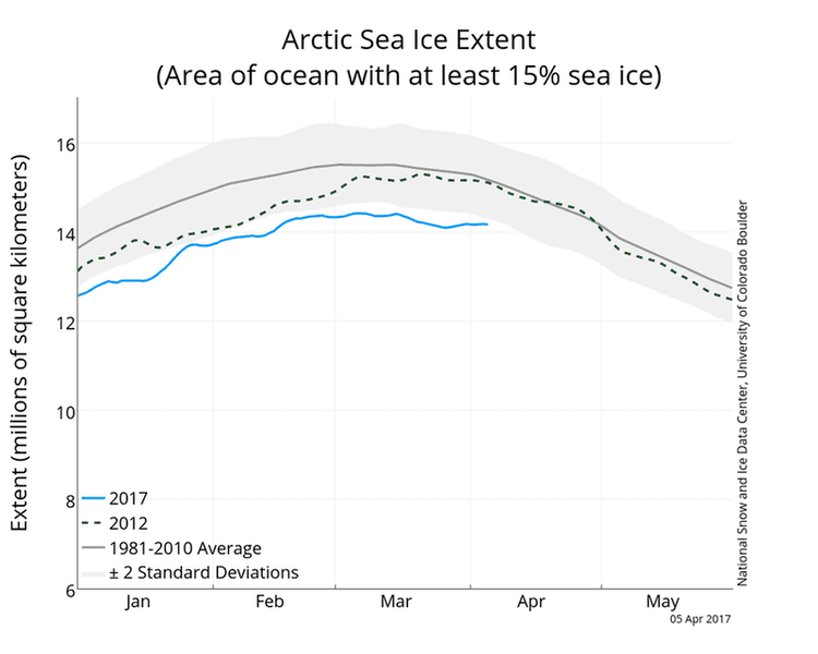

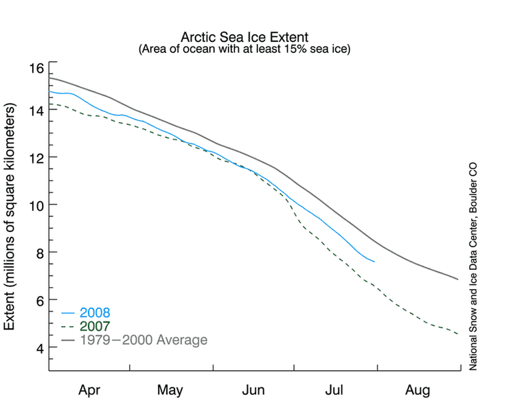

Arctic sea ice.
While average Antarctic sea ice has increased slightly, this is a function of ozone depletion and it's effect on circulation patterns in the Antarectic, not some alleged global cooling. other areas of the Antarctic, especially the western peninsula, are experiencing a sharp decline in average sea ice extent.
Antarctic total ice mass is decreasing to the tune of about 84 gigatons of ice per year.
