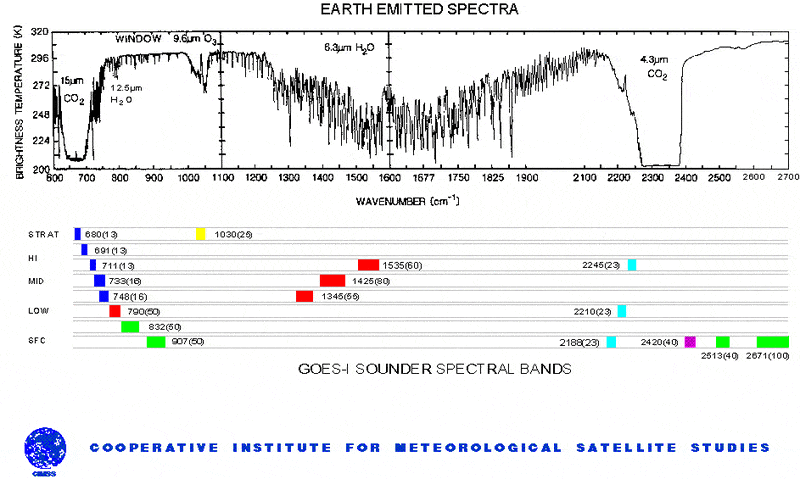

negitron said:
I don't believe this is correct. See the following chart: (chart removed... see above... sylas)
That's not thermal infrared. Look at the wavelengths. The wavelength for thermal infrared radiation is more like 10 microns, way off to the right of the diagram where reflectance drops off sharply. The AVHRR channel 1 band in your chart is pretty much centered on visible light, I think.
I may not get back to this for a bit; but a quick look at my references confirms my opinion that the warmth of a cloudy night is a very strong greenhouse effect from cloud; meaning it is due to thermal emissions, not reflection. A detailed cloud model does consider infrared reflectance; but it is not a major factor, and not the main factor for why cloudy nights are warmer.
I'm not totally confident on this; but for the time being I still think my original statement is correct as given.
Cheers -- sylas

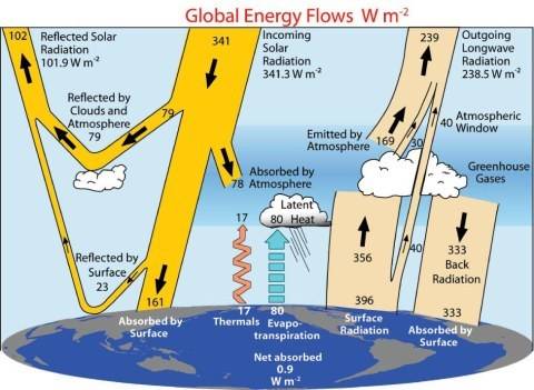

EVERYTHING radiates infrared spontaneously. It's a basic property of matter. What I am describing is not any different to what you are used to; I'm describing the thermodynamics of the world you and I experience right now. This includes cooling at night, and condensation on the washing I forget to bring in this afternoon.
The Sun pays all the energy bills that matter.
It may help to bear in mind that the backradiation from the sky is real. It's measured. It's significant; night time included. Hence as you try to work on the physics of what happens to clouds and temperatures, you know for a fact you are going wrong somewhere if you think the atmosphere doesn't provide radiation to the surface at night, all night. That follows anyway from the physics; but it's still a handy sanity check to keep us on track.
With that in mind as an empirical fact about the world, let's see how the physics works.
The atmosphere does cool down at night; but the heat capacity of air is sufficiently high (about 1 kJ/kg/K) that it easily remains warm all night. There is about 104 kg of air per m2, so the heat capacity of the atmosphere is roughly 107 Joules/m2/K.
This radiates to space about 240 W/m2; which is offset by a net energy flow up from the surface. Don't be confused by physically naive descriptions which suggest that greenhouse warming means that there's a net flow of energy from atmosphere to the surface. Its the other way around. The atmosphere is heated from the surface, at night as well as in the day. The effect is analogous to a blanket, which keeps you warmer even though it is colder than you are, and the net flow of energy is still from you into the blanket. The atmosphere is warmed by the surface, or a blanket is warmed by a body; and that means you are warmer than if you were radiating direct to space without impediment.
I don't know the rate at which heat energy is lost from the atmosphere at night, but will be less than 240 W/m2. Over 11 hours we have about 40000 seconds; so the energy lost at night should be, ball park, 107 J/m2, or less; which is enough of itself to lower temperatures about a degree.
This is not an attempt to actually calculate the temperature change; just give a bit of basic thermodynamics to show that there's plenty of heat in the atmosphere to keep things mild over the span of a night. In more detail, we would find that night time usually brings an "inversion" in the lower part of the atmosphere close to the surface, so much of the temperature drop occurs low in the atmosphere, which makes good sense thermodynamically. And this means, by the way, that the clouds don't actually drop in temperature as much; most of the changes to cloud will probably be related to the inversion and currents.
And given that the cooling is pretty limited, effects on cloud are going to depend on a lot more than the simple measured facts of backradiation and associated cooling. The physics of cloud is actually pretty complex.

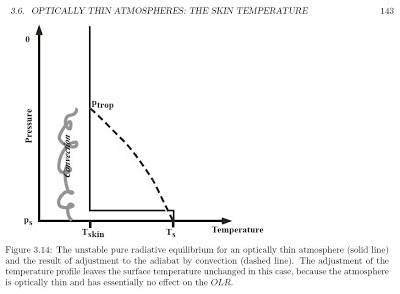

By the way, the whole atmospheric greenhouse effect requires a declining vertical temperature profile (i.e., the lapse rate). So even testing the infrared abilities of CO2 in a confined setting, you're not going to get a good picture of how the actual atmosphere works.
  • #82
Precisely.

I have been learning a lot about atmospheric physics over the last year or so by studying Principles of Planetary Climate, by Professor Pierrehumbert, of the University of Chicago. The book is not yet published; but is under contract to be published by Cambridge Uni Press. A draft, complete in the first eight chapters, is available online, and it is geared towards his teaching of the unit "Geosciences 232: Climate Dynamics of the Earth and Other Planets".
I like the book because it is pretty comprehensive, and quite mathematical, which suits my learning style. It is technical and I am a long way from understanding it all, but the first few chapters are fine, and already take you through a range of diverse examples in different planets. The download is available at the above link, but it is pretty large. You might like to have a look.
There's nothing there that is particularly controversial... or at least there shouldn't be. Plenty of other undergraduate level texts do the same kind of thing, including consideration of physics sufficiently generally to apply to a range of planets.

  • #102
vanesch said:
I have to say that I'm intuitively puzzled here. I think I'm going to follow your advice and go through the book. Intuitively, I would have thought that you get BETTER heat transport (lower thermal resistance) if you have both radiation and convection, rather than convection or radiation alone. You would think that you have "resistors in parallel", no ?
I'm not quite sure I understand. This diagram (from Trenberth, Fasulo, and Kiehl) shows global energy flows. If you're referring to the surface, it loses heat both through radiation and convection.
