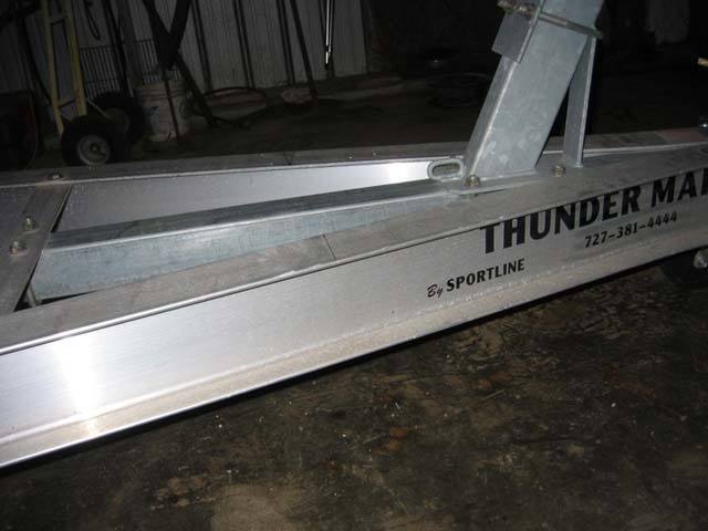

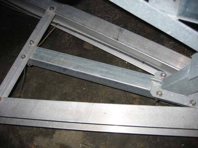

I want to shorten my boat trailer so that it will fit in my garage in the winter, It has to be able to be put back together for the summer. Trailer is built with 5" aluminum I-beams running down each side. My idea is to cut the two beams and splice back together with 4 pieces of aluminum channel about 15" on either side of the joints so two 30" pieces would sandwich each of the I-beams and be bolted together so they could be removed once a year. I beam material is 1/4 " and channel to be used just fits inside and is .29" material.
Coments or help would be appreciated.

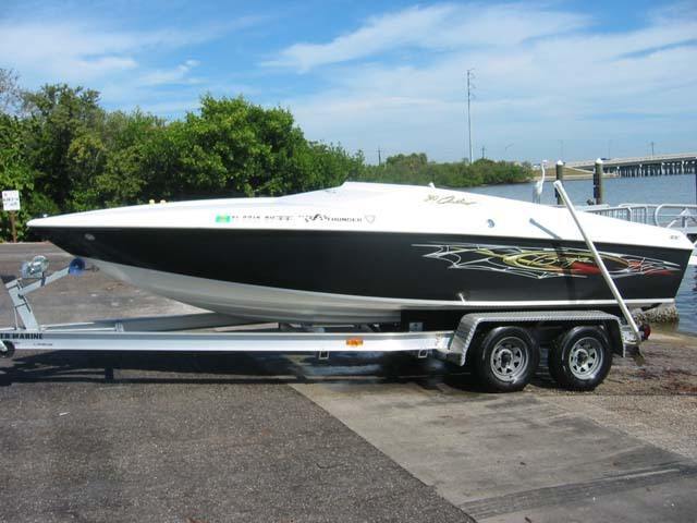

This is exactly what I have. Did the trailer come with the boat? What kind of boat is it?
Yes the trailer came with the boat, a 20' baja outlaw. The boat will fit in the garage with about 6" to spare but the trailer tung sticks out about 2' past hinge point. If I don't lock it up, I'll loose it.

Yes even diagonally, that's what I was trying because it minimizes the height requirement. If you get this pic you can see that I have to cut just behind the winch sort of in line with the bow of the boat. The 2x2 seen running down the middle would be unbolted from the crosssmember and pull out with the front being removed. This tube is bolted through the two beams where they terminate and has the hinge piece and hitch connected to it. I hope you can enlarge pic so you can see what I am talking about. Look forward to your comments.

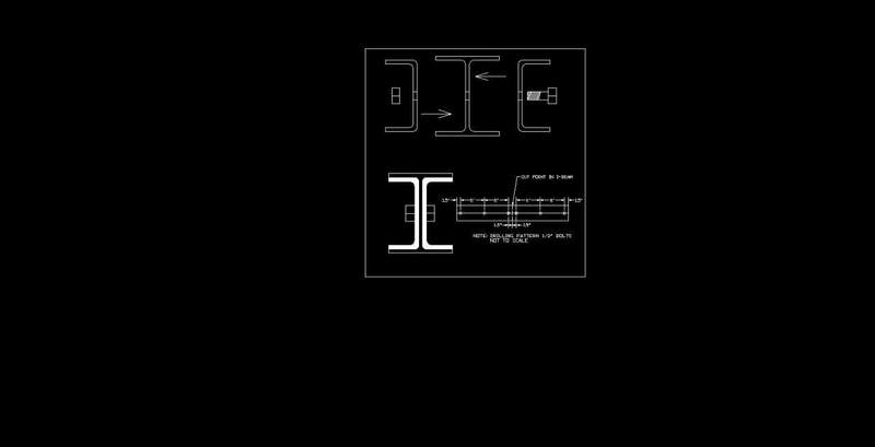

I would consider cutting. but I would make 2 crossmembers out of channel, wide enough to go over the I beams. trim the web out so that the outside ends of the channel crossmember go over the Ibeam. then weld and bolt both crossmembers to the trailer so they sit back to back and bolt them thru. then plate the I beams, and weld and bolt one side of the plate. that boxes the ends of the frame at the point you cut it at. I would also put a diagnal piece in the rear section between the added crossmember, and any existing one. if no rear crossmember then a pair in a v shape. use large bolts, nylon head nuts and big washers (also preferably welded in place) on both sides of every bolt. and quite honestly, I'd use a dozen or so 6 on the sides of the splices, and 6 to hold the crossmembers together.
now, insert disclaimer here: I am not a structural engineer, marine trailer engineer, civil (or un-civil) engineer. material composition can vary significantly, and some alloys can NOT be drilled without starting cracking problems that can NOT be stopped. welding should be done by someone VERY GOOD. << deleted by berkeman >>
be careful, be safe, closed coarse, professional driver, do not attempt this at home, milage may vary with driving style
dr
opps you'd need 18 bolts

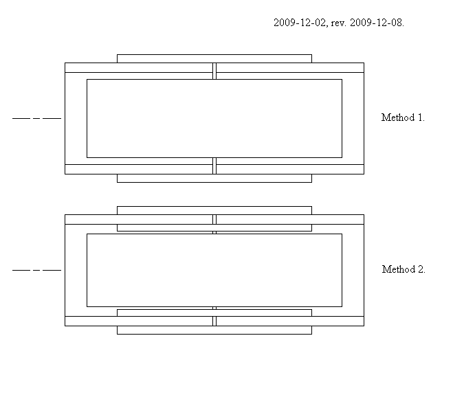

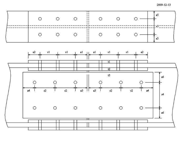

You can cut it at the garage-fitting length, then make a really strong inner sleeve to fit inside the 2 halves, and put a serious set of pins through these parts. Look at the trailer hitch receiver inserts: they are held together with large 1/2 inch or 5/8 inch pins. It has worked for farm tractors for 100 years.

How do you think the trailer hitch ball is held to the truck's receiver hitch? A large pin thru a 2 inch square steel tube. If the inner tube fastenings make you nervous, add a large piece of chain the length of the trailer extension, dropped over a large hook at each end.
For this whole inner sleeve, NO WELDING NEED BE INVOLVED. A couple of big bolts, and one clevis pin.
