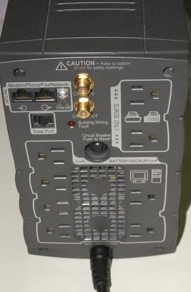

Have an APC Back-UPS XS 1500, Model BX1500LCD (same as BR1500LCD), computer battery backup unit. It came equipped with two 12V, 9AH batteries wired in series. After 2 years and a power outage resulting in the batteries being almost completely discharged (control software not running), they are at the end of their life as evidenced by drastically reduced run time.
Rather than having to replace the batteries for $50-$80 every 2-3 years for 20-30 minutes of run time with my system, I would like to use 2 flooded, size 24M, 12V, 80AH Deep Cycle Marine/RV batteries. I haven't done the math, but I'm guesstimating that these batteries would provide 2.5-4 hours of run time for my system. If I were to do this, I would do it right, utilizing battery boxes, good connectors and wiring.
I have 3 questions:
  1. Will the UPS be able to keep the marine batteries charged?
  2. After a deep discharge, will the UPS be able to recharge the batteries in a reasonable amount of time (36 hours max)?
  3. During a long power outage, would my UPS be able to supply power to my system for several hours without overheating? If not, can this be mitigated by modification (ventilation, heat-sink)?
The UPS is a high-end consumer unit, so I'm hopeful that it is fairly well made and heavy duty enough to be able to handle the assignment.

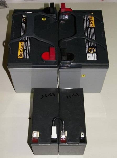

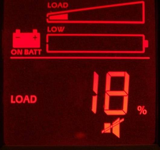

Well, I did it. In the end I decided to play it super safe and go with sealed AGM deep cycle batteries, rather than flooded, even though I would have gotten twice the backup time for about the same price with flooded batteries.

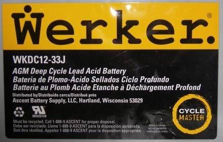

I purchased two Werker, 33 AH, deep cycle, AGM batteries from a local Batteries Plus store for about $80 each. Also purchased 5 feet each of red and black, stranded, 10 gauge wire; a 1 foot piece of stranded 6 gauge wire; 2 copper terminal lug connectors; crimp (butt splice) connectors; and spade terminal connectors.

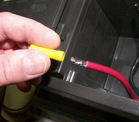

Procedure

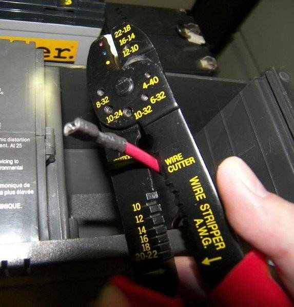

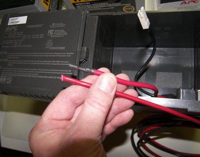

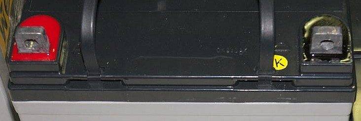

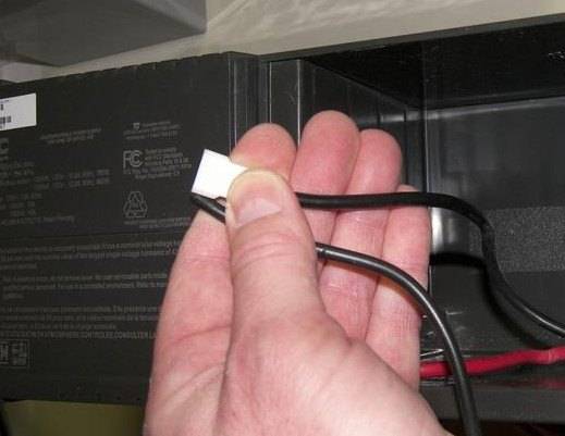

After removing the old batteries, I cut the existing battery connectors off the battery leads in the UPS batter compartment.

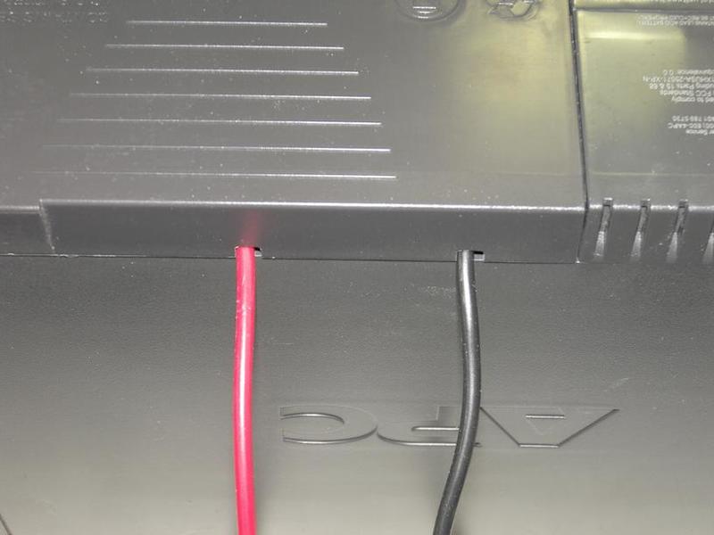

I stripped a little less than a cm of insulation from the ends of the leads and connected the 5-foot wire extensions with crimp connectors. CAUTION: I DISCOVERED THAT THE LEADS HAVE VOLTAGE EVEN WHEN THE UNIT WAS UNPLUGGED AND WITH THE BATTERIES DISCONNECTED! SO KEEP THEM APART! Must be an internal battery.
I filed two small slots in the battery compartment cover to allow the extension wires to pass through the case. I made sure I placed the slots a few inches apart.

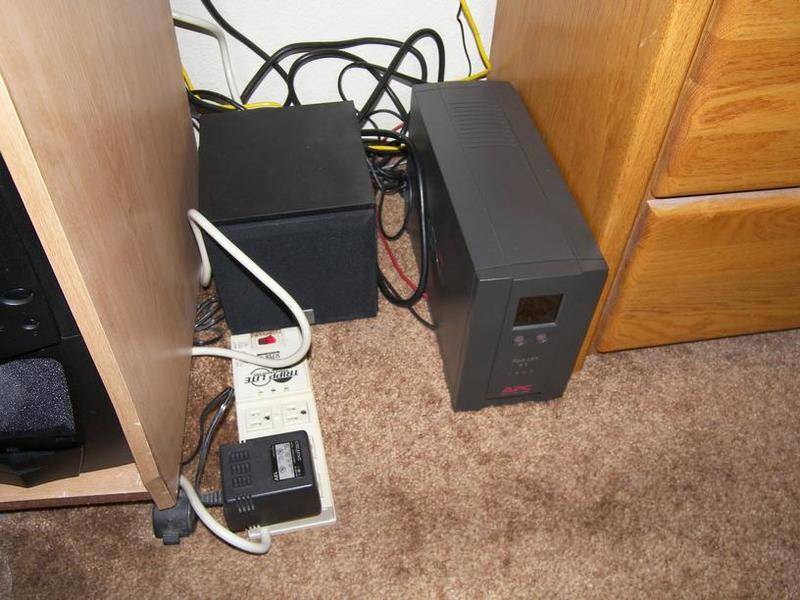

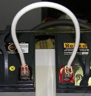

I wired the batteries in series to achieve the 24 volt input my UPS requires, using the lug connectors and the piece of 6-gauge wire.
I positioned the UPS and batteries on apposite sides of a small chest located next to the computer, ran the wires and made the final connections.

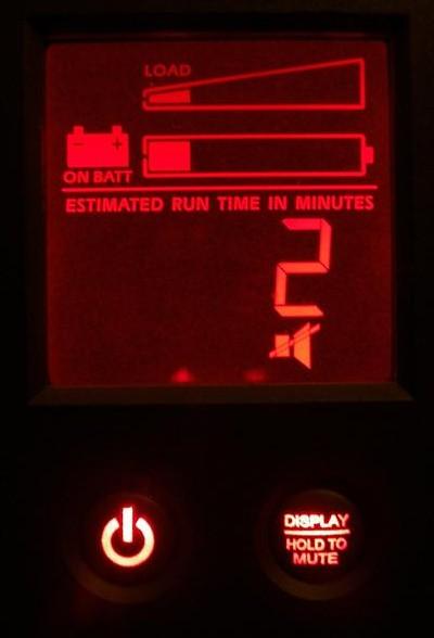

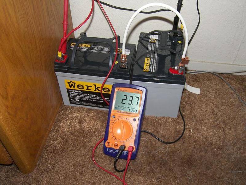

During testing, I ran my system for 1.5 hours on the new batteries and everything worked fine. The batteries, battery leads, connectors and series connection remained cool to the touch.
The USP is equipped with cooling fans that came on intermittently during the test and kept the UPS from getting too hot. However, these fans did not come on during the subsequent recharging and the top of the UPS was hot to the touch during this time.

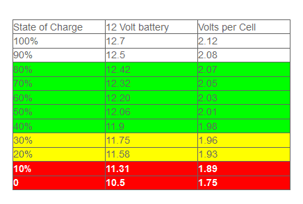

I measured the battery voltage under load during the test and found that it slowly dropped over the course of the discharge as expected. After 1.5 hours, the voltage was down to 23.5 volts.

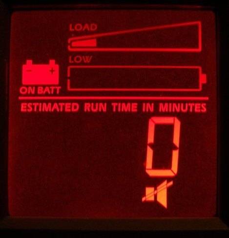

The only issue I have now is that the UPS doesn't detect that it is now attached to much higher capacity batteries and as a result, shuts down the PC after only 10 minutes on the batteries if connect with the USP cable. If I'm the PC is unattended at the time of an outage, this behavior is fine as the PC shuts down gracefully and the batteries are protected from too deep of a discharge. However, if I'm working on the computer, this behavior is undesirable to say the least. My workaround is to disconnect the signaling cable, thus preventing the UPS from sending the kill signal.
Update: I was able to run my system (150-175 watt load) for 1.5 hours on the batteries and still had about 15% charge left!
I had to unplug the data cable, as the UPS wanted to shut everything down after only 10 minutes. However, I was able to get the UPS to recalibrate by adding an additional 150 watt load (light) and running it on the batteries with the data cable unplugged for 45 minutes. Total load was about 330 watts and remaining charge was 14%. Now after recharging, the unit indicates I have 30 minutes backup time, which would be correct if I was using the specified 9AH batteries.
Overall, I have to say I'm quite pleased with the results of the upgrade. Shouldn't have to worry about batteries for at least 4 years now.

After getting everything going nicely, I looked at the load (watts) and found to my surprise that the load for the Server, Firewall and modem only used 95 watts (monitor off). Or 130 with the monitor on.
Huge
I was expecting a load of around 250 watts. I forgot that the server uses a much less powerful video card which in turn uses far less power than the average PC might.
Instead of about 3 hours, run time is now estimated to be around an incredible 6 to 7 hours !

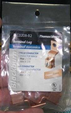

Also, I used 8 gauge wire for all connections. But instead of cutting the connectors at the APC, I added Male connectors to my wires that needed to connect to the APC. That way (for whatever reason) I could always go back to the OEM setup with two OEM batteriies if I wanted to.

Hi Guys,
I'm back. Was doing a search and came upon this article I posted 5 years ago. Update: Werker batteries died. Just replaced with 2 35 Ah Duracell Ultra AGM batteries.
Regarding the suggestion for a safety fuse, wouldn't the built in UPS circuit breaker and the GFCI outlet I have it plugged into provide adequate protection? If not, please elaborate. I'm all about safety and will add a fuse if it is really necessary for safety.
Having issues with the setup now. It looks as though the batteries are being drained rather than charged, but I don't want to replace the unit without confirming that the batteries are indeed both good. The are wired in series for 24v and I measure 24.8 volts for both and 12.51 volts and 12.41 individually hooked to the setup while running. Seems that the UPS charging circuit has failed. I too the batteries back to Batteries+Bulbs to have them tested and charged once. The said the batteries are good. I do wonder why they don't have equal voltages.
Don
A big part of why breakers and fuses are used is to protect the wires from overheating. If something shorted out in the wiring going to the UPS the you would have on the order of hundreds of amps flowing through the wires and batteries. It is best practice to put current safety devices closest to the source. Often in packs with multiple batteries you will find a fuse in the middle of the stack somewhere.
A quick search finds:
http://www.atbatt.com/amstron-replacement-backup-battery-for-apc-rbc9.asp?utm_campaign=google-pla&utm_category=ups-batteries&gclid=CjwKEAjw0NytBRD-1d3QsdHNpR0SJACGXqgRJh3SVqddS2mtLLSsVNvgOIAFR9JhiByh-rbui3_EChoCc4vw_wcB
BoB
Technically, you need to protect the wires that carry power from your batteries up to the UPS.
A good sized fuse in that middle wire between your batteries will do that.
The UPS should protect itself so you can use a fuse sized for the wire. 30 amp will be okay for #10. Auto parts stores have convenient inline fuseholders, be sure to get one rated 30 amps.

It appears that the UPS is not charging the batteries and is in fact slowly draining them. I will have to replace the UPS. Thinking of ordering a used one online. Will save money and probably end up with more robust unit than another APC consumer grade unit. Thinking of getting an APC Smart-UPS.
I read the history of this thread. I think you did an excellent job.
You already replaced your batteries but for the benefit of others, I would like to say that the cause of death was likely to be sulphation. Instead of buying new batteries, the old ones may have been rescued. A battery charger with and "equalize" (i.e. desulphate) cycle is the key. If you don't own one or can't borrow one, then take the batteries to a shop and let them try to equalize the batteries to bring them back to life. If it works, it is much cheaper than new batteries.
5 years is a very good lifetime for AGM deep discharge batteries that have daily charge/discharge cycles. In a UPS application they could last much longer than 5 years. But they should be equalized about once everty 30 cycles.

is there a chance of finding a schematic for the charging section?Look carefully, sometimes one finds a loose terminal; (push-on's are notorious) or a cracked circuit board.
What voltage dos the charger produce at battery terminals when you open-circuit the battery (maybe unhook that middle wire) ?

Also look inside those crimp connections for "green grunge", the product of copper and sulfuric acid fumes.

I disconnected the batteries and am charging them one at a time with a Schumacher Battery Extender 3A charger/maintainer. It is one of those completely automatic microprocessor models. It says it has 8 modes, one of which is desulfation. The first battery, which is charging now was at only 45% charge, so the UPS was definitely draining them.
I will open up the UPS to check for anything obvious. If I end up replacing it, I will replace it with an APC Smart-UPS, which in more robust and puts out a real sinewave which is much better for the equipment. Going to go for used, as they are too expensive new.

Anorlunda,
Shouldn't the UPS have kept the batteries charged, preventing sulphation? I thought that the sealed AGM batteries lose water over time and that that is the main reason they die.
Don
No error codes or chirps. The PowerChute software indicates that everything is A OK, but the charge % keeps going down.
OK, both new batteries are not fully charged. Now to find a good used Smart-UPS to replace my failed unit. Anyone have any advice and/or suggestions? I would imagine that all the APC 1500 VA units have 24 volt battery input, but will have to confirm.
Don
  • #31
I had the UPS working fine for years with the two 33 Ah batteries, so I don't think the capacity of the batteries is causing my current issue. I think something has failed in the electronics and that is what is causing the UPS to slowly drain the batteries. My line power is good.
  • #32
Your logic is good.
All i can suggest is to measure the voltage it puts across the batteries while charging
and
if you can find the charging traces on the circuit board, they have to go through something that controls the current.
Probably also a low ohm resistor that measures the current as well.
If you're lucky you'll find something not conducting. Check voltage across anything in series with battery charger .
You'd be surprised how many things get fixed by a close visual exam. Look for cracked solder joints.. I recently fixed cracked solder joint at a 1/2 watt surface mount resistor .
You need a jeweler's loupe...
www.bourns.com/ProductLine.aspx?name=pulse_power_resistors
I'm out of ideas - good luck.
  • #33
Don
Correction. I meant to say both batteries are now fully charged. Used external charger. I will do autopsy on my UPS. If I don't find anything obvious, I will replace it. Will update what I find.
Don
