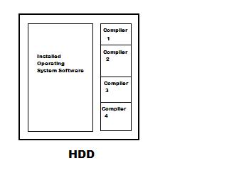

I know that there are different compilers for different platforms. But am I suppose to have a different compiler if the hardware architecture of computer is same but the operating system is different?
Suppose I have two computers. One running Windows Vista 32 bit processor. Second PC running Linux/Unix/Solaris but it has the same 32 bit processor. Is a different compiler still required or I can use the same compiler that I have on Windows Vista. I know that Unix comes with built-in C language compiler.
You need to use a compiler that targets your machine, and your operating system, and the standard libraries either provided by your operating system or the compiler. Some of the system functions you call in your program (e.g., printf if you are using C, the stream insertion operator operator<< if you are using C++) are not a part of the generated executable. Those functions/methods are instead part of some standard library that is dynamically loaded at execution time. The name of the library function loaded at execution time, and its behavior, had better be consonant with the assumptions built into the compiler.
You can't run a C++ compiler written for Windows, on a Linux system, even on the same processor, for the same reason that you can't take the Windows version of Microsoft Word and run it on a Linux system. The two compilers use different OS-specific functions to interact with the user and the operating system that they run on.
In addition, the compiler has to generate code that properly uses any OS-specific functions for the OS that the program being compiled is going to run on (the "target system"), and link to appropriate libraries. In principle, a compiler that runs under Windows could generate both programs that run under Windows and programs that run under Linux, but I don't know if any actually do this.
Compilers installed adjacent to Operating system. Wrong or correct?
I know that the examples of System softwares are Operating system softwares and Compiler softwares. All the application software needs Operating system so that the application softwares can be able to run. What about the compiler softwares are they installed on Operating system or they are some special software which are installed adjacent to operating system? I get this doubt because as Unix OS has a built in C compiler, the C compiler must be installed adjacent to Operating system, not on the Operating system like the way Application systems are installed. Am I wrong? I don't know if I am using the correct terminology. Sorry about that.
A compiler IS an application. It's application is to compile programs. ANY application can be built in as part of an operating system if you so desire.

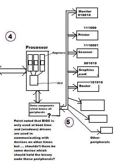

pairofstrings said:
After the data is processed in the processor, the RAM and the BIOS comes into picture, and BIOS knows the peripherals very well.
Normally, other than at boot time, the BIOS isn't used. The operating system will include it's own drivers for all the components on a computer. The main exception to this would be MSDOS.

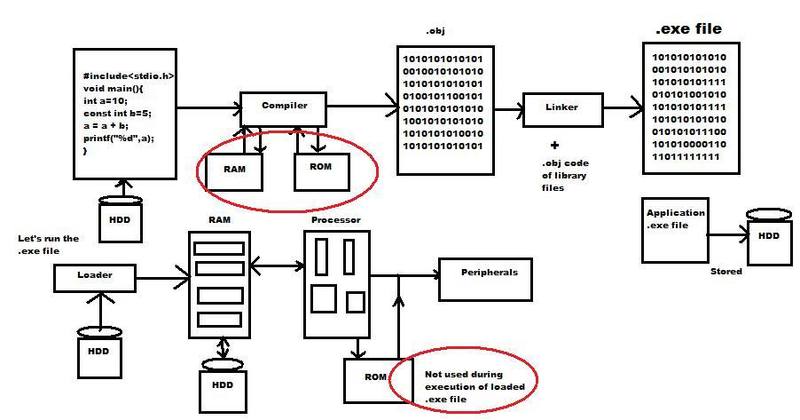

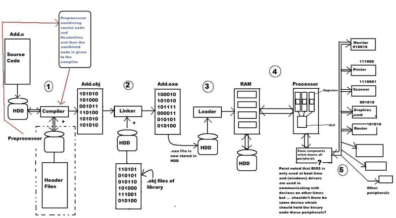

1. Preprocessor actually copies the header files into the source code and then the combined file is given to the compiler. Preprocessor takes the header files from the HDD. The compiler generates the equivalent binary code of the file and we call it as .obj file.
2. Linker is a part of compiler. Linker adds the binary code of .obj files of library funtions into the binary .obj code and a new file is generated called .exe file. This .exe file is stored in HDD.
3. When we run the .exe file, Loader, which is an Operating system software loads the .exe file into the RAM. RAM contains segments.
4. During execution all the mathematical operations are performed by ALU present in the processor. Required data is fetched from RAM and data is stored in registers and ALU takes-in the required 'numbers' from these registers and computes them as required and result is put in some register in CPU and then this result is sent back to the segment in RAM. CPU don't store any data.
I have noted the point that BIOS is used only during boot time, and the operating system will include it's own drivers for all the components on a computer and main exception to this would be MSDOS, but ...
5. (Figure explanation, continuation from point 4) Data is sent back to the RAM. We can even make changes to the values assigned to the variables during execution. Now, if I want to send data to the devices. (My thinking) Then there is "some component" to which the binary equivalent of this result can be sent. The result is attached with the binary code of device. This predefined binary code is stored in "some component". This signature which is [binary code + binary equivalent of result] is now sent to the devices. Now, let's say I want to display the result of the following program on the monitor.

If "some component" really exists and if I want to program this "some component" and create the device drivers am I suppose to use Assembly language?
The exception, which is MSDOS, where BIOS is used, how could BIOS be different from "some component" ?
Please help.
EDIT: I don't want to know how monitor or other devices connected to a computer works. I am just asking that if BIOS is not used on the other times then can "some component" (if it exists, please see figure) be used? Should there be "some component" attached to the processor? And we know that processor is sending data back to RAM but is the processor really sending data to other devices as well or, is RAM sending the data to the other devices but not the processor?
Sorry if my post is confusing, but I tried to give good picture of how I see processor in giving signals to other devices. I think when processors execute drivers provided by windows, the drivers must also have some predefined binary code and I think that this predefined code is stored in "some component" which will help in identifying the correct device attached to the computer.
My main question is point 5. But if you see any problems in other points, please correct it.
If the binary code is matched at the terminal of the monitor, then data/result is allowed by that device into monitor's processing circuitry and there the data/result is processed and it is displayed on the screen. Correct or Wrong?
I think you would do well to read up more on how monitors work. Your terminology is very confusing and suggests that you do not have a good understand yet of how things end up getting sent to the monitor and in what form, although it is somewhat close.
pairofstrings said:
The exception, which is MSDOS, where BIOS is used, how could BIOS be different from "some component"?
The BIOS includes code that interfaces with most components on the system (monitor, keyboard, disk drives, ...). Most operating systems other than MSDOS, include their own code to interface with those components, and the code for each component is called a device driver.
The answer to your question is that device drivers or BIOS are "software", machine language code that interfaces with some component, while an actual component is "hardware" made up of elecrical circuits and mechanical components.
For the OP's sake, I'll clarify a bit on BIOS and "device drivers". Device drivers are just programs that are written to interact directly with hardware. The BIOS (Basic Input Output System) is just device drivers that have been burned into ROM so that they are there as soon as the computer is turned on and do not need to load from a hard drive the way all other software does. All computers have some form of BIOS because it is the BIOS that does the first step in loading the operating system (which then takes over and may or may not use the BIOS code any further --- early versions of Windows used the BIOS but I don't know if current versions do or not.)

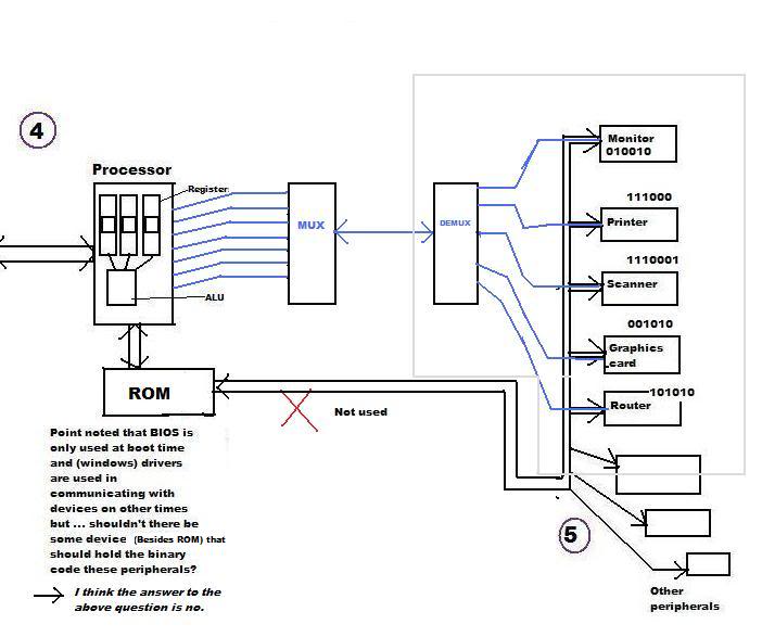

pairofstrings said:
Multiplexers near the processor end and a De-multiplexer at the monitor end because data cannot be sent in parallel way.
Current PC processors have over 1000 connector pins (1155, 1156, 1366). A lot of those pins are used for ground, but there are a few parallel busses on a typical processor, memory address bus, memory data bus, pci express busses, usb ports, sata ports, ...
You can start at wiki and then go browsing through other articles and references. Example wiki link:
http://en.wikipedia.org/wiki/LGA_1155
Note that a monitor is going to be connected to the graphics card, not as a separate device.
then I think all we need is an Multiplexers near the processor end and a De-multiplexer at the monitor end because data cannot be sent in parallel way, I think, parallel way can be done but it's not feasible
Total nonsense. Parallel data is faster than serial data and is COMPLETELY feasible. When PC's first came out, all printers were driven by a parallel cable and I think many monitors were as well. Serial is cheaper which is why it is used now.

Parallel data is faster than serial data and is completely feasible. When PC's first came out, all printers were driven by a parallel cable and I think many monitors were as well. Serial is cheaper which is why it is used now.
For some high speed peripherals that use relatively long and cheap, somewhat noisy ribbon cables like IDE hard drives, keeping parallel signals in sync at high speeds became an issue, which is part of the reason (or the "excuse") for the change from parallel IDE cables to serial SATA cables, and cd/dvd peripherals had to follow along as IDE got replaced by SATA, but the main reason was probably that reduced pin count connectors and cables are cheaper. SCSI devices use a better cable system, and acheived high tranfer rates up to 320 giga-bytes / second, but cable length and the number of attached devices became an issue when trying to go faster, so there is a transition towards SAS (serial attached scsi).
Memory data busses are very fast and still parallel, 64 bits wide for LGA 1155 and 1156, and 96 bits wide for LGA 1366. PCI Express busses are 16 bits wide and some motherboards (X58) have two of them, in addition to single bit wide PCI Express busses. These parallel interfaces are connected directly to the motherboard, not over cables.
Monitors using VGA connectors use analog signals sent in parallel for red, green, blue, and sync data. DVI cables can send VGA type data or digital pixel data sent as three serial data streams for red, green, and blue. HDMI drops VGA type data, but adds the ability to send RGB color data as YCbCr.

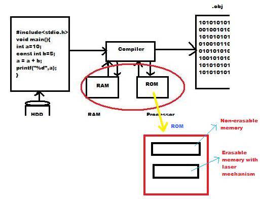

My question is: If I am using a keyword 'const'. Please see the following C language program.
Code:
#include <stdio.h>
void main{
int a = 5;
const int b = 10;
printf("%d %d", a , b);
*/b = b + a ;
printf("%d", b);*/
While the program is successfully compiled, the 'const' keyword used help in assigning values to the variables and memory is allocated to the values on ROM. Right? Now, as program is compiled nicely, a .exe file is generated and file is stored on HDD. End of story.
Now, I want to run this .exe file that was generated. I double click it and as usual loader loads the .exe file into the RAM and we have processor but there is no ROM in our discussion here again. The usage of 'const' keyword is taken care of during compilation. That means, a particular code is generated by the compiler when we use 'const' keyword that makes ROM not to get involved in loading the .exe file through loader into the RAM.
Same concept goes for # define ? A preprocessor?
Code:
#include <stdio.h>
void main{
int a = 5;
const int b = 10;
*/b = b + a ;
printf("%d", b);*/
Absolutely not. NOTHING changes the values in ROM. Do you even understand what the acronym ROM stands for?" Look it up.
The "const" just causes the compiler just puts a numeric value in the memory that is allocated for the variable "b"
I'm not clear what you mean by all of this. As you correctly point out, ROM has nothing to do with the process you are describing, and the "const" keyword has NOTHING to do with ROM.
So, basically compilers are softwares written to implement the language which is documented. I tried to deduce the answers from the posts in my thread called "How programming languages are created?" but now I see clearly how compilers intend to do their work. So, same thinking goes for all translators?
