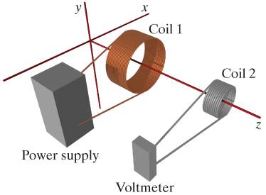

Two coils of wire are aligned with their axes along the z-axis,as shown in the diagram. Coil 1 is connected to a power supply and conventional current flows counter-clockwise through coil 1, as seen from the location of coil 2. Coil 2 is connected to a voltmeter. The distance between the centers of the coils is 0.14 m.
Coil 1 has N_1 = 565 turns of wire, and its radius is R_1 =0.07 m. The current through coil 1 is changing with time. At t=0 s, the current through coil 1 is I_0 = 15 A. At t=0.4 s,the current through coil 1 is I_0.4 =6 A.
Coil 2 has N_2 = 280 turns of wire, and its radius is R2 = 0.03 m.

At time t=0, what is the magnetic flux through one turn of coil 2? Remember that all turns of coil 1 contribute to the magnetic field. Note also that the coils are not very far apart(compared to their radii), so you can't use an approximate formula here.
At t=0 Phi_1 turn = ? T m2
***THIS IS WHERE I'M STUCK*** :confused:

No dimensions are given on the coils so I suppose you will assume that the coils have no width in the z direction.
It looks like you are going to have to calculate the B field due to coil 1 and integrate that at coil 2 to find the flux at coil 2. Do you remember what sort of field a current in a loop generates?
After pondering about this question for the better part of half an hour, while watching SC2 :), I was able to figure it all out! :D
for the first two parts where it asks for the flux, phi.
I used the equation Phi = B*n.hat*dA
where B_loop = N * (μ_0/4*pi) * (2*pi*r^2*I) / (z^2+r^2)^(3/2)
where N, I, and r belong to the current carrying wire. and z is the distance between the center of both coils.
Then Phi = B * dA
where dA is the cross sectional area of coil 2.
Emf for a single loop was then found using Emf = -dPhi/dt
dPhi would be Phi(0.4) - Phi(0) and dt is 0.4 - 0
Emf for the whole loop was found by multiplying the previous answer times the number of loops in coil 2. Emf(tot) = Emf(single loop) * N
E_nc was found by using E_nc = Emf / (2*pi*r*N)
where E_nc is the non-column electric field. r is the radius of coil 2, and N is the number of turns in coil 2. 2*pi*r*N = the total length of the coil
