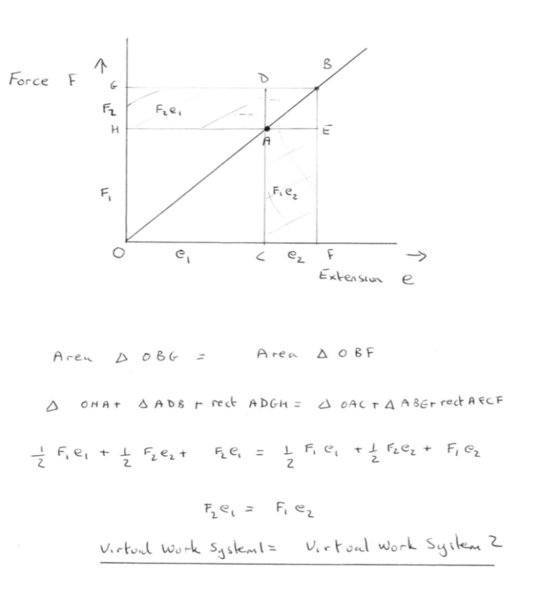

I am going to take a guess that it is the Virtual Work you are having trouble with. So I will present a geometric explanation/proof of the action.
You will need to accept Clapeyron's theorem that true strain energy is 1/2 Force times displacement. Virtual Work can be developed from this, entirely consistently but remember that virtual work is also a mathematical dodge or trick.
So consider a linear-elastic system loaded by a force or system of forces F1 resulting in displacements e1 and subsequently by a second system of forces F2 resulting in displacments e2.
Plot the load line force - displacement curve OAB, with OA being the line for F1 and AB the extension for the subsequent F[2.
I will return at the end for the reasons for using the x-axis for the displacement and the y-axis for the Forces, this is conventional.
The true strain energy imparted by F1 is 1/2 F1e1represented by triangle OAC. The strain energy due to F2 acting alone on the system is 1/2F2e2 represented by triangle AEB.
Now if we follow F1 by F2 the forces of F1 are displaced by F2 so additional energy has to be supplied. The total energy is 1/2 (F1+F2)(e1+e2), represented by triangle OBF.
It can be seen that OBF is made of two triangles plus the rectangle AECF, shown double hatched, which is F1e2
This rectangle is known as the Virtual Work of forces F1 moving through displacements e2
A bit of mathematical jiggery pokery shows that this equals the rectangle ADGH ie F2e1 which is the Virtual Work of forces F2 moving through displacements e1
Some judicious choice of F1, F2, e1 & e2 allows the statement
Internal VW = External VW
To return to the choice of axes, the real strain energy is the energy between the load line and the displacement axis.
The energy between the load line and the foces axis is called the complementary energy.
In this linear case they are identical, however they can be usefully employed in some cases, and lead to a Castigliano theorem.
https://www.physicsforums.com/attachment.php?attachmentid=54122&d=1356030712
(Edit by Borek: new attachment added, old left for reference)
I will try again with the attachment.
For the benefit of any mod tidying this up I have renamed the attachment from virtualwork1 to virtualwork2.
Both have the same content.

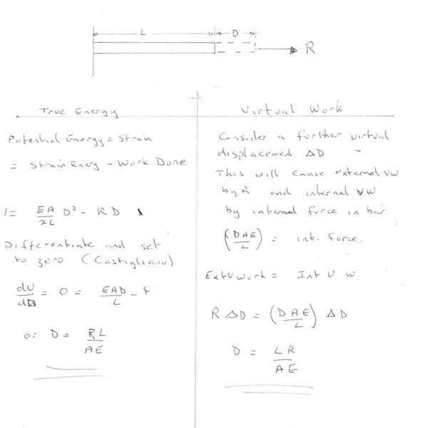

I have worked out your example in both true energy and virtual work methods side by side.
I have tried to follow your notation of a bar of length L, extended a distance D under a force R and in equilibrium.
I will leave you to work out the comparison with direct force methods.
Because you seem to have some uncertainty about the following terms I have defined them
Potential Energy
Strain Energy
External Work done
for the true energy method
For this method note that the first term is the Clapeyron strain energy and contains the factor of 1/2 that was causing the difficulty.
Note also that this 1/2 is canceled by the 2 that results from the differentiation when we seek the minimum potential energy.
and
Internal virtual work
External virtual work
Virtual displacement
for the virtual work method.
Note that there is not factor of 1/2 since the definition of a virtual displacement requires all forces to remain unchanged during such a displacement.
It can be seen that both methods reach the same end result. Failure to do so is probably as a result of an substituting an inappropriate formula somewhere.
