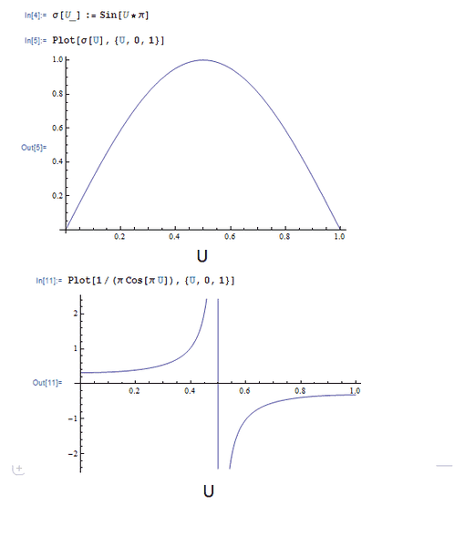

Entropy is positive, so it can't approach zero from the other side. Entropy tends to zero as you approach zero temperature from either side. If you plot entropy versus energy for a "finite system" (that is, a system with a maximum energy), the graph looks qualitatively like a parabola or a sine half period. See top plot of attachment. The maximum energy that the system can hold is 1.
At low energy, the entropy is near 0, because with little energy, there are few ways to arrange the energy. (Think of it this way. You have n energy quanta and m bins to put them into. You have fewer options if n is small.) But at high energy, entropy is also near 0, because the system is filling up with energy, and there are fewer ways to arrange the holes. (Since this is a finite system, you can only stick at most, say, 2 quanta of energy into each bin. Then, when they are almost all filled up, you have few options of ways to arrange the vacancies.) The vacancies or holes behave more or less analogously to energy quanta.
If you plot temperature versus energy, it looks like bottom plot of attachment. For this example, temperature doesn't ever reach 0. But for a larger system, temperature can get very close to 0, and entropy will get relatively close to 0.
So, in a system where there is a maximum energy capacity, a low energy (positive temperature) and high energy system (negative temperature) can behave very similarly. But the positive temperature system deals with quanta of energy and the negative temperature system deals with quanta of holes.
