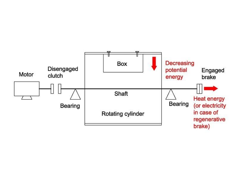

Welcome! :smile:
In this case, you are using the magnetic field in the electric motor as a brake, just to slow down the free fall of the box from the higher platform onto the lower one.
That brake effect could transform most, but not all (due to real life inefficiencies, like Eddy currents), of the potential energy of the box into heat or into chemical reaction inside a battery.
At most, the robotic arm is only needed to produce the horizontal displacement of the box out and onto the platforms.
A regular crane uses its engine to rise a load, and only brakes to lower it.
I would repeat your experiment using a horizontal cylinder with the box fixed to its wall and rotating about a fixed axis or shaft.
I would need to input mechanical energy into the shaft in order to move the box from the lowest natural location to the zenith.
I would only need to let go the shaft for the gained potential energy of the box to relocate it to the lowest point again.
I fully agree with post 13 above.
