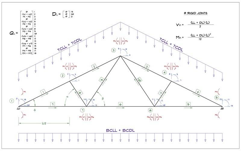

I've kind of hit a road block on the moment calculations for my truss designer project. The current spec TPI 1-2007 calls for using the matrix method in determining the moments. However, I need to be able to run this app without doing a full blown analysis using RISA or some other FEA type product. For now I've gone with the simplified method which is the method used in the TPI 1-1995 standard, at least I can produce a solution.
If anyone has any ideas on how to do a simple matrix method analysis of a common fink truss please send me in the right direction. My biggest unknown with this would be how to deal with the fixity of joints at panel points and heels. I've just ordered a copy of Hibbeler's Structural Analysis to further research how best to deal with frames, trusses etc...

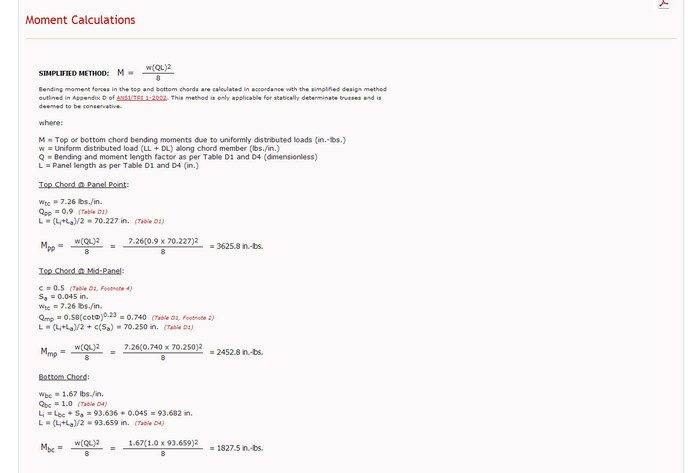

One thing I found really helpful was the samples provided in the previous editions of the TPI 1, its really quite disappointing to see no such example calculations in the current standard (2007).
Here is a typical output for a fink truss showing moment calculations:
I also added deflections calculations using the virtual work method, curious to see how this stacks up against an identical truss with same loads and lumber analyzed with Mitek or Alpine:

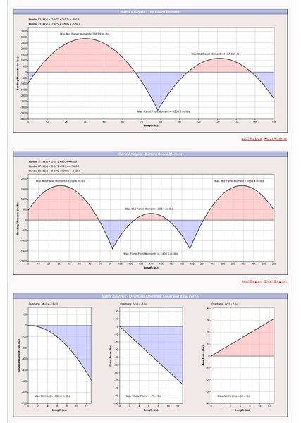

Here is an example of the output of my matrix analyzer for the Fink truss:
I've even inserted the correct code to account for the additional loading/moments if there are overhangs. I double checked my work by modeling up identical trusses (beams and trusses members) in both Strand7 and Solidworks (COSMOS/Simulator). My result were within 1.5% or better, so I'm really happy about that.
My only concern with my analysis is how correct my analog for the truss really is. What I mean is that the bending moments are heavily influenced by the amount of rigidity of the joints. Fixing the joints (where chords meet) or pinning them dramatically affects the bending moments and even the axial and shear loads to some extent. My analog model is basically rigid at the heel and peak joints and pinned at all other web-to-chord or web-to-web joints. This seems to approximate most closely the moments calculated using the simplified method (pre TPI-2002). The nice thing about the matrix model is that I can easily pin or fix joints depending on how I want to model the truss. I might even add in some logic so that the user can pin or fix certain joints just to see how it affects the final loading and member design of the truss.
What I also found quite interesting (and expected) is if you use a stronger type of lumber on the top chord as compared to the bottom chord. The top chord loads increase and the bottom chord loads decrease. The matrix analysis is almost as good as FEA. It's really quite cool to be able to calculate something like this just using a bunch of matrices.

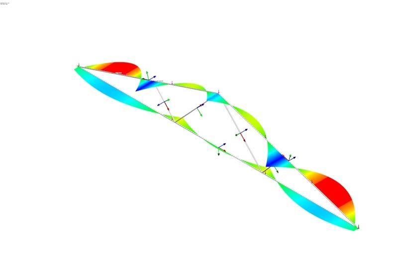

Leaving the peak joint as a rigid connection without exploring the implications of a pinned or semi-rigid joint seem like a cop-out to me so I spent most of the day attempting to release the peak joint so that it could act as a pinned (zero moment transfer) joint. For the web members I accomplished a similar task by altering the 6x6 stiffness (k') matrix so that it only included the axial terms, thereby eliminating any shear or moment forces, making these members axial only or simple pinned truss members. However, for the top chord members it was not such an easy task. I initially tried eliminating the row of the matrix that was responsible for the far end moments (pinned end), but it some became apparent that the interplay between moments and shear forces was more than I had originally thought. I was about to accept defeat but then after spending a couple more hours digging about online I came upon a gem of a paper published in 2010 in the Electronic Journal of Structural Engineering by M. E. Kartal. This paper outlined a couple of methods for obtaining the correct stiffness matrix for semi-rigid connections. With this information I was then able to add in feature so that one can select whether the peak joint is rigid, semi-rigid or pinned.
I then tested it for accuracy against an identical model in Solidworks Simulator for both the pinned and rigid connection at the peak joint with near perfect results. Unfortunately, Solidworks does not allow for adjusting the rigidity of connections between beams in its interface so I currently do not have the tools to test the accuracy of the semi-rigid model. However it appears to present the correct trends when compared against the other two options. If someone has a copy of ANSYS or some other reasonably high end FEA software I would be interested to see how well it will compare with third party verification.

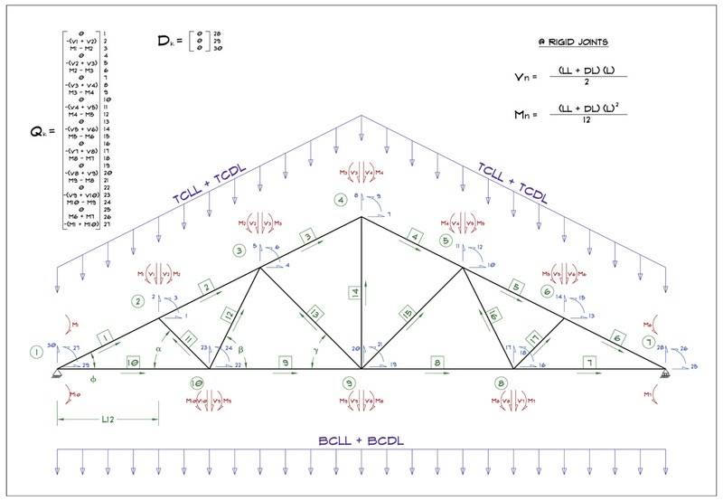

Starting to work on the modified queen truss, here is the schematic for the matrix analysis of it. The structure stiffness matrix will be a 30 x 30 matrix (900 values), its no wonder they didn't do this sort of thing prior to our modern computers, imagine trying to calculate this by hand. :)
Compare this to the fink truss, which has a few less webs and hence the computations are less 21 x 21 matrix (441 values)
These schematics really say nothing about which members are pinned, semi-rigid or rigidly connected. The stiffness matrix (k) for each member is what determines that.
In my analysis I am treating all of the webs as pinned jointed on both ends and only capable of transferring axial loads (classical truss members). The top and bottom chords at panel points are treated as rigid connections. The peak joint is treated either as rigid, pinnned or semi-rigid, this is user configurable. The heel joint is treated as rigid or semi-rigid. My reasoning and justification for these model settings is based on a number of papers I have compiled on the rigidity of joints of MPC wood trusses. I have saved each one and will compile a reference list at some point to accompany the truss designer documentation.

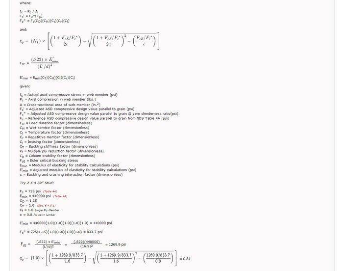

Currently working on the plate calculations. Those will be rather lengthy but the upside is the summary is what most people will want or need, however I will show each lateral resistance, tension, shear, net section and moment check for each plated area of each joint. I'm doing one by hand first before I code it and I've already used 10 pages for the calculations and I still have to add the heel joint. I hope if nothing else people can use this app to at least better appreciate all of the checks that go into a simple truss.
26 pages of truss plate calculations for one simple fink truss.
It's no wonder we use computers for this sort of thing.
Now I just need to take it from this pseudo-code into Perl code with a bit of fancy logic and we've got her licked. :)

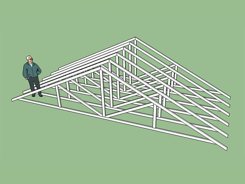

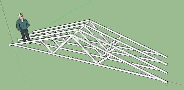

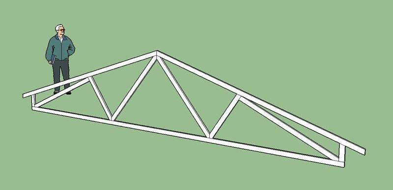

Added SketchUp 3D (.rb) file output for the truss geometry. This file, when copied into the SketchUp plugins folder, will create a menu item within SketchUp allowing for unlimited creation of the given truss geometry within SketchUp. I think this feature will be particularly interesting to those DIYers who wants to draw up their own model and plans using SketchUp.
I've updated the code so that the plugin now allows for user input in order to specify number of trusses and spacing of the trusses. For example 4 trusses @ 24" o/c would give you:
The actual truss geometry cannot be altered within SketchUp it is hard coded into the plugin when it is created by the calculator. For different truss sizes and shapes it is simply a matter of creating and storing separate .rb files for them. Dropping these files into the SketchUp folder sets up the menu item. This method seems to be the easiest for interacting with the SketchUp API.

I have the raised/energy heel working now for a fink truss where a vertical member and strut is required (heel height greater than 12" approx.). Still working on the wedge and slider cases, they are actually easier to calculate and program, but I figured I would tackle the difficult one first.
When the angle between the strut and top chord exceeds 10 degrees I then apply a scarf cut to the strut at its centerline (try a raised heel height that exceeds 24" and you will notice the difference).
Here is an example of a fink truss with a 18" raised heel. Notice there is no scarf cut at the top of the strut where it meets the top chord.
This is the same truss I used in my 28'x48' garage:

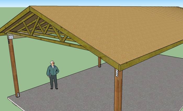

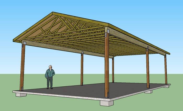

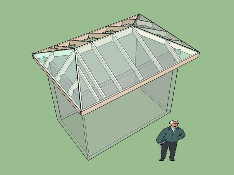

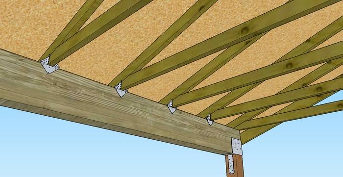

Just playing around with SketchUp a bit today and trying out the new sheathing, rakeboard and fascia capabilities in the Plugin.
The roof of this simple structure took all of 10 seconds to create, the rest about 20 minutes. I didn't realize Simpson Strongtie hardware is available in the 3D warehouse, good to know.
I'm not going to say anything about lateral bracing of this structure, just modeling for fun.
One can go so far as to put all of the H1 ties in. I could waste an entire day messing around in this software, way too much fun.

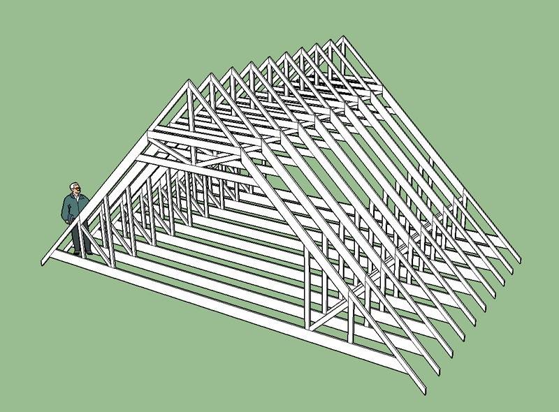

Version 1.1.6 - 11.26.2015
- Added Fan and Mod Queen common truss types.
- Structural outlookers (vert. & horz.) enabled under advanced roof options for Common (Fan & Mod Queen) truss types.

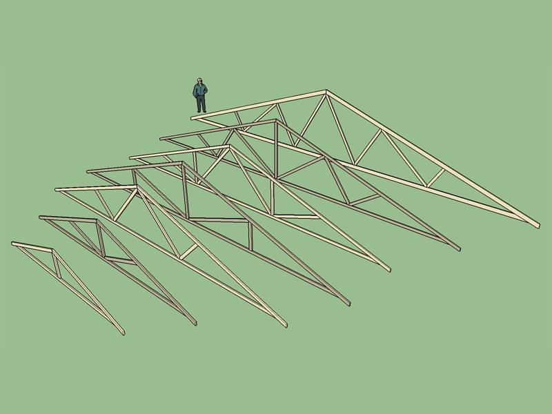

A quad fink truss (10/9) with a raised heel (slider):
http://www.selecttrusses.com/wp-content/uploads/Ag1.jpg

A friend of mine several years back took a stab at putting together a truss plant and I worked with him at it until local Nevada politics put him out of business. I built many a truss with him but the engineering was all done with Compu-truss so seeing the technical aspect is very interesting to me.
I'm curious as to whether you will be including the Girder truss into the collection you have here. ?
By the way a note from the "guy in the field", if anyone comes up with an H-1 clip that you don't have to bloody your fingers installing It will be incredibly popular.
Thanks again, two bloody thumbs up. :smile:
As an afterthought I probably would have "liked" nearly every post you did here, but I wouldn't want to appear to be spamming the thread.
