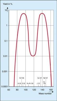

and how do they produce nuclear waste
The U-235 is fissioned and in doing so produces fission products. The fission products are considered waste, since they themselves cannot be fissioned (some of them would be useful in medicine and industrial activities, however). Here is a graph of the different fission products produced and their relative proportions:
http://www.euronuclear.org/info/encyclopedia/f/fissionyield.htm
(I also attached this graph at the end of this post.)[/color]
Notice how the graph is bimodal — i.e., it has two peaks. One peak is around atomic mass number 95 and the other peak is around atomic mass number 140.
Another type of waste produced is comprised of so-called transuranics. These are produced starting when Uranium-238 captures a neutron which subsequently decays to a proton. Since elements are defined by the number of protons their atoms have, as you can see this produces an element that is higher than — or trans — Uranium. The process continues for a ways beyond uranium, and we get an assortment of elements — that were not in the fresh, unburned fuel — including Plutonium, Neptunium, Curium, and Americium.
