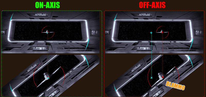

With both objects rotating: If the incoming ship moves off its docking axis by more than a little, it is at risk of colliding with the docking station walls as they rotate, different parts of which are moving at nontrivial velocity relative to the ship.
Imagine the 2001 space clipper rotating on its axis to match the wheel's rotation so it can slide inside. They have zero relative velocity only if their axes are colinear.
If the clipper is coming in not dead centre, but, say, to the left by a few metres, it is still rotating on its own axis but that is no longer lined up with the station's axis.
If it continues on its course, the ship is at risk of getting clobbered by the docking station wall which could be rotating at quite a few m/s.
Picture is stock photo. It does not represent my scenario; it is merely a visual aid.
Even if disaster is averted, the ship now has a much more complicated route to get back on track since it is still rotating its own axis . It may actually back off, realign and try again. )Whereas, if they are not rotating at all (relative or absolute), and the ship moves more than a little, the docking station is not at risk of clobbering the ship - the relative velocity will be trivial, since it is no more than the ship's own error - 1m/s. (Also, getting back into position is a trivial.)
IOW, in a nonrotating approach the consequences of an error are linear (1:1) - whereas in a rotating approach they can be arbitrarily multiplied (5?:1).
Everything is not all relative when rotation is involved.And as an added bonus, a nonrotating docking port's throughput is limited in capacity only by size. You could have a half dozen ships, all berthed side-by-side in their own bays, simultaneously and independently docking and undocking.
In a rotating port, exactly one ship can be in-play at a time, and must be moved into and out of the pipe to make way - a bottleneck. What if there's an accident in that bottleneck? Everyone's trapped.

Having the hub rotate with the station is by far the most simple solution in almost all respects except for docking, but this does not mean its impossible to make a fairly safe (automated) approach and docking/berthing mechanism (i.e. sensors/computers/actuators). Such mechanisms already exists today which take into account the relative orbital motion during approach and docking to a non-rotating station. To me it seems far more feasible to "extend" the capability of such technology to include spin-axis approaches than to design the whole bay to rotate relative to the station. Note that there will be a cylinder around the stations spin axis in which a spacecraft will be safe, i.e. not collide with the bay, so even if the approaching craft is a bit off-axis there is plenty of opportunity to safely nudge it back on-axis for a good berthing position (i.e. a position/attitude range where the spacecraft almost passively can maintain a near-zero relative motion while robotic arm grab the spacecraft).
Even for larger stations with larger bays it seems far more feasible to have the bay rotating (i.e. fixed with the rest of the station) and let any docking/berthing mechanisms (temporary) rotate, e.g. using rails or similar. For very large stations with very large cylindrical bays that potentially can house multiple spacecrafts its seems far more feasible to have the approaching spacecraft station themselves non-rotating over a section of the bay where robotic arm on a long rail (potentially going full circle around the bay) then can grab it and slowly accelerate it to zero relative motion with be bay. Such a mechanism also includes the possibility to do spin-axis docking with or without spacecraft rotation so it should be quite flexible (as a design baseline at least).
Yes. A rotating bay may well be more efficient - as long as everything works as it should. My point was merely that it is not the best when it comes to safety margins. Faults are harder to recover from. Rotating docking has intrinsic relative velocities that become dangerous in a way nonrotating docks do not.
A five second lapse or glitch in attitude control at just the wrong moment can end up disastrous in a way that it cannot with a nonrotating dock. In other words, rotating is less fault-tolerant.
Naturally, as you point out, larger bays can have procedures that act to mitigate such risks - but that's for a future phase, innit?

sophiecentaur said:
Jow is this any more of a problem than an aircraft landing on a runway that's not aligned with the wind (which is most of the time). Planes use suspension and tyres to cope with far worse situation than would exist in a spacecraft docking at almost zero velocity.
Just so we're clear, this is the scenario I'm describing.
No amount of suspension and heavy-duty tires will minimize a broadside collision with a station wall.
  • #35
It's a bit 'how long is a piece of string?' without some idea of the actual speeds involved. A plane will be landing at 100mph and can't go much slower. A docking space ship can be approaching at less than walking speed and can slow down, reverse or nudge left and right. This is more like the mooring a boat scenario. We use inflated fenders for a 4ton boat coming up against a dockside and they work fine for dealing with a nudge of 1knot. I really can't see any significant problem with this aspect of space navigation.
Your images assume a certain style of engineering - to make good cinema pictures. After a long space journey it would be no hardship to approach your destination over several hours; no need to zooooom in to the dock.
