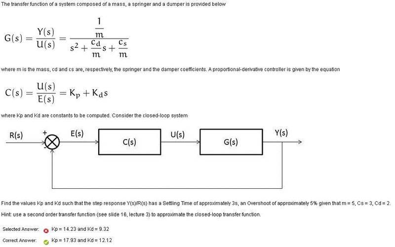

Hi,
This question on PD control is from a practice quiz.
1. Homework Statement
If you can't see it- the question asks to find values for Kp and Kd such that the system achieves 5% OS and has a settling time Ts of 3s.
Cs = 3
Cd = 2
m = 5
ω_n^2/(s^2 + 2ζw_n + ω_n^2) - 2nd order form
Overall Transfer Function I found:
Y/R = CG/1+CG = [ (Kp + Kds)/m ] / [ s^2 + ((Cd + Kd)/m) + ((Cs + Kp)/m)]
Ts = 4/σ (2% of final value); where σ = ζω_n
From the transfer function I found above i noticed that it is not exactly in the 2nd order form. However I was told that we still set
ω_n = SQRT[ ((Cs + Kp)/m) ] {1}
because when we add a derivative controller it only adds a zero which effects the numerator, not the poles on the denominator.
firstly we know for 5%OS → ζ≈0.7
from Ts = 3 = 4/ζω_n
→ ω_n = 4/3ζ = 40/21
from eqn {1} - solving for Kp
Kp = (ω_n^2)m - Cs = (5)(40/21)^2 - 3 = 15.14
At this point I stopped because their answers were Kp = 17.93 and Kd = 12.12.
Could you explain if the process i used is incorrect because I can't understand what I am doing wrong.
Thank you
(btw I just joined Physics Forums like an hour ago)
There are often many ways to solve control problems. Plot your solution. Does it meet the design criteria?
hi, can someone please have a look at my working to see if I am on the right track, I spent many hours on it and I am not even sure if this is the correct way.
donpacino, I am a beginner in Matlab, I am not sure how a plot would verify my results.
run a simulation to see if your KP and KI values meet the criteria for rise time and settling time.
